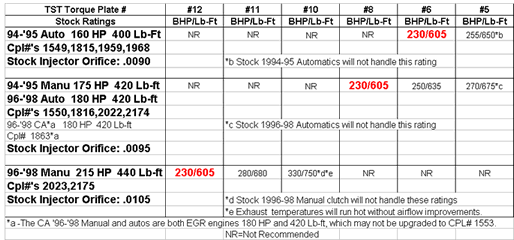

#10 plate? According to the tst page it isn't reccommended for the 98 12 valve w/ auto. I've attatched the chart. Will the 8 be enough? will the 6 be too much for my stock tranny w/ lots of miles on it?

The plates get more aggressive as the #s go down, except for a #100 plate, but that would be out of the question any way. So since a #10 plate may be too much for your tranny, a #8 would only make things worse. Same thing with a #6.
The most common plates are a #10, #100, and #0 these days anyway, no one really uses the others.

Here is what I'm confused about. The shop guy I talked to at TST reccommended the #8 on a stock tranny. The info I'm getting here is to go with a #10 but it will slip the tranny anyway. I'm looking for more advice or experiences with adding a tst plate on a stock tranny.

Don't know what that part number on the tranny is, but you have a 47RE. The 47RH were the early, non-electronic transmissions, and the 48RE are the 3rd generation trannys.
I have a #8 plate, and a stock tranny and no problems so far. However, I don't do any hard launches or hot rod my truck.
