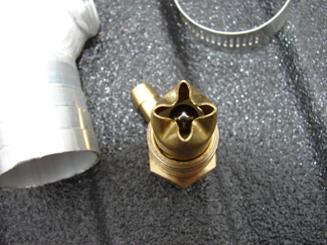

1. I used the kit from Northern Tools. Seemed a bit expensive ($70) but it worked good.

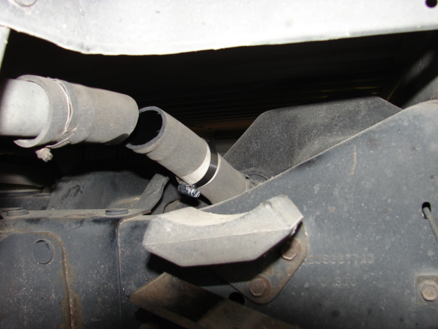

2. I cut the filler hose so that the kit would be as upright as possible per instructions with the kit. This is in order to not have the tank overflow/fill. There's a little "ball-float" in the bottom of the feed devise that prevents fuel from flowing when it gets close to the top (pretty sure I didn't say that right, but...it works).
3. When installed in the filler tube correctly, it sits upright. (see pic I hope)

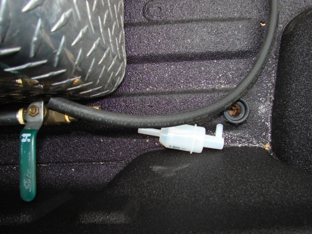

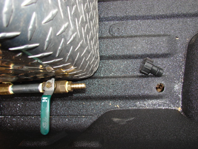

4. Next I had to decide where to drill out the hole for the hose coming from the aux tank to go thru the bed. I also didn't want the hose rubbing on the metal-bed-hole, so I needed something to protect it. I looked around the garage and found a garden hose mending piece...you know, if your garden hose connector is damaged you can replace it with a new insert (sorry, I'm not doing well with describing today...see pics I hope)

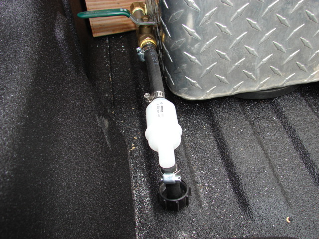

....next, FILTER. I was pretty confident that the used tank was clean, but wanted to make sure. I also did not want to go with a fancy set up of filters and separators (on a budget). So, I still knew I wanted a filter. So, I went to ebay and found a diesel fuel filter for a Mercedes !! Looks kinda like a lawnmower fuel filter, but hey, if Mercedes uses it, I figure my DODGE CUMMINS TURBO could use it... (see pic)
The rest was pretty much just making the hose connections and ensuring the clamps were snug. Guess what---IT WORKS!
