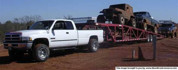

I LOVE my Mach 2's on my otherwise pretty much stock truck. Never dynoed though....but my guess is around 280-300ish RWHP....Smoke is VERY managable by themselves....EGT's are never an issue...even with a full 48' Enclosed trailer or 53' car hauler with 2 rigs on it........o yeah....mileage didnt change from stock.....still 17-18 MPG unloaded....
