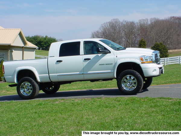

I could hang out at the dealership all day my local dealer is great they even lifted my dads mega cab [/IMG]
