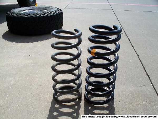

Wife called today and said the brown truck was there and I got a package she couldn't move from the porch to the garage
She ended up opening the box and rolling these in one at a time:
They are from Coil Spring Specialties and are supposed to be a 2.5" lift over stock and are supposed to compensate for my bumper replacement. Will be installing them on Sunday along with an offset trackbar bushing from Lazarsmith.

They do, and I believe they are heavier than the stockers as RJ mentioned (and not just because of the added 2.5"). I still have the stockers in the attic. I will try to remember to get a pic of the stockers, Skyjackers and these all next to each other.
~Rob

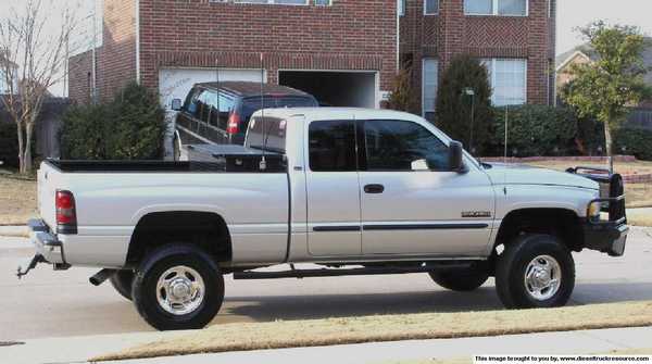

Yep, it leveled out nicely with that combo. I don't think the SJ D25's gave me a true 2.5" lift because of the bumper.
Here are some pics with the SJ D25's and stock rear:
Aftermarket 17" rims with 305/70-17's
Stock 16" rims with 285/75-R16s
I put airbags on the rear 2weeks ago. If the new springs make the truck "nose high", I will adjust the rear with the bags.
~Rob
~Rob

I had my CSS springs still in back of my truck so I just mic'ed them with an adjustable spanner
. (My Mic is home). Definately a bigger diameter on the new springs, compared to stock. I'd guesstimate 1/8" stouter .... at least 3/32nds.
Does this mean less compression? Don't know. Guess we'll both find out.

The new springs have .095" thicker wire diameter than the stockers, and were exactly 2" taller free height... installed height started at .250" higher than with leveling spacers.
The original springs were .040" different side-to-side (driver's thicker, of course), but the new coils were only ~5-10 thousands apart.

Factory Spring on left (155,000 miles)!
RJ
