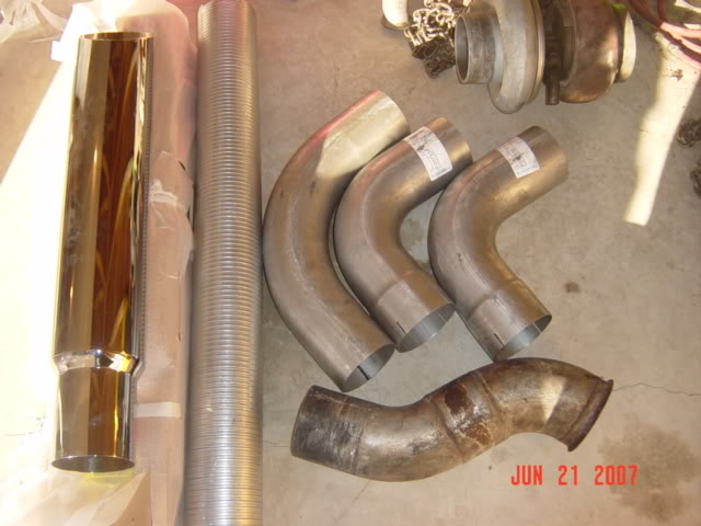

This is everything that my exhaust system entails. including the down pipe. I used the 2 short radius 90s to kick the stack over closer to the bedrail. but it makes it sit higher than I like. so I'm going to use only the long radius 90 and lower the stack some. you use band clamps for flexpipe to hardpipe connections. some are stepped some are flat clamps. depends on what you need. mine is 5" id flex and 5" od hardpipe. so I slide the flex onto the tubing and use a stepped band clamp

I prefer the stepped band clamps myself as the flat ones always seem to leak where they bolt together.

ya the stepped clamps are pretty good at sealing up.
