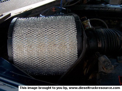

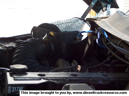

Well I got my wix 42790 and started work on the AFE switch .I used the heat shield and welded a 4" pipe in it , the wix goes through the shield (removed stock pipe I was able to reuse the filter minder

Why did you ditch the AFE?
I have 3 trucks with AFE mega canons all 3 trucks had a light dirt film in the intake and edge of turbo.If the trucks drove mostly on pavement I might of left the AFEs on, paper filters better for high dirt enviroments.My 1st gens all have the stock paper filters and one of them is at 700K I dont think AFEs would of let it run that long.my.02

What is right next to your air filter? a huge wastegate actuator? a vacuum canister?
Did you notice any difference in the sound of the turbo after switching? Louder, quieter?
I'm running a BHAF now, but was going to replace it with a AFE Race filter soon.
Banks exhaust brake
I think its just bit quiter
