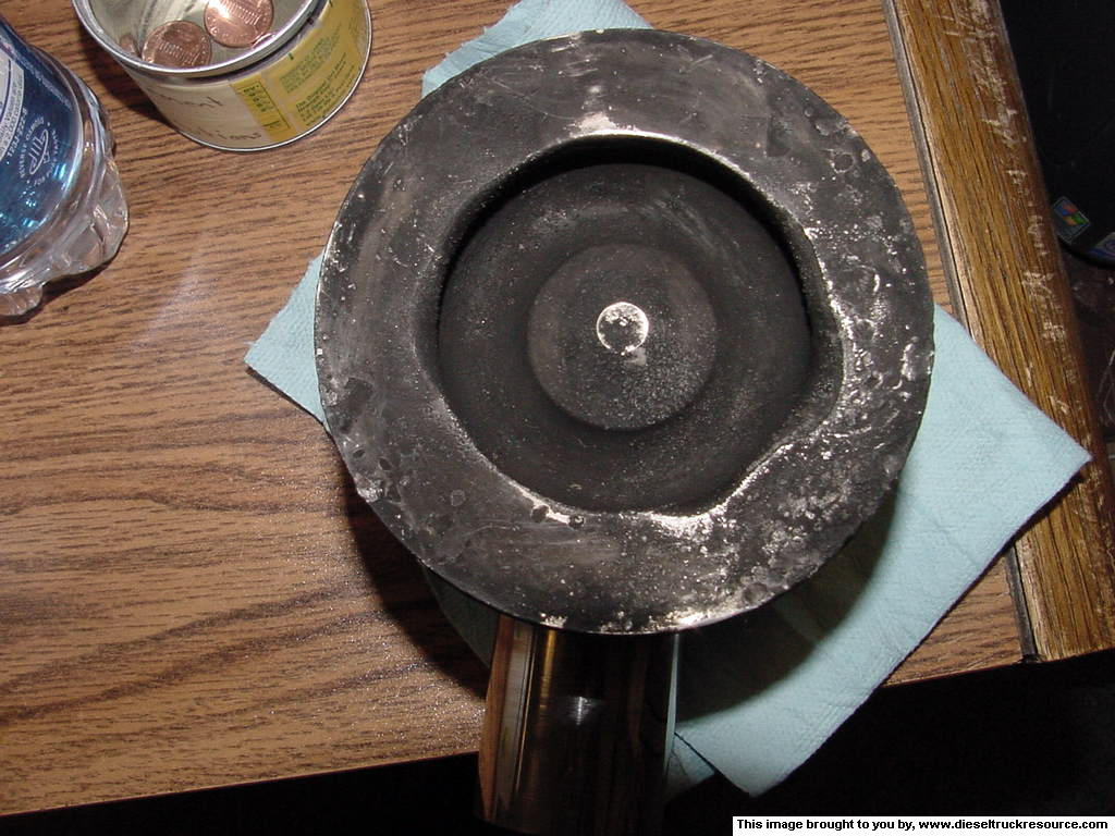

Wait to get the pyro, IMO. I learned the hard way. It probably would've only cost me about 1200 bucks in parts to fix after I melted some pistons, but a year and a half later and about 6 grand poorer after I kept adding to the wish list rebuilding it, it's running again SO if you like to drive your truck, wait for the pyro, I don't remember exactly what I paid for mine but I know it can't be more than 150 bucks, that's cheap insurance as far as I'm concerned. I'll try to get a picture of my pistons in here soon. It's so much worse than the one above. But anything melted is bad.
