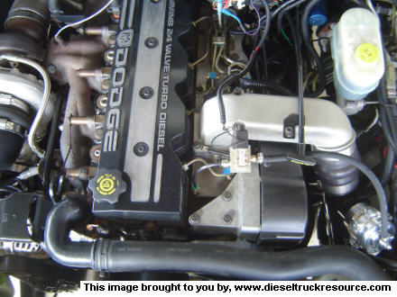

bd is the only ine I know of who has a kit. it is microprosessor controlled so you are not relying on the pressure difference to operate it. most are actually pulled open by vacuum only, so obviously will not work well on a diesel.
It also has nothing to do with a wastegate.

how does that tial sound on your truck, we run them on our race cars, but Im yet to hear one on a truck

Kindove like PiSsSsSsSs best thing I can compare it to is the sound of a air compressor relief valve

The sound depends on the boost level.
It sounds decent at 35-45lbs. BUT, it sounds WICKED at 95lbs on my old twin-turbo truck.
McPherson which TIAL do you run on your race car. This on is a 50mm. Is yours the same model or different.
~Wes~
