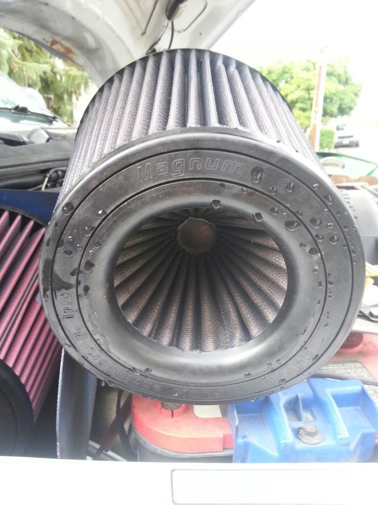

Found replacement
So after debating this for months I decided to bite the bullet and buy a
S&B filter that replaces competitors filters. My AFE is almost 8 years old and no matter how good i cleaned it I would get signs of crushing after heavy WOT events. so AFE RACE filter would be 80ish $
the S&B filter #CR-90021 was only 54$ my AFE was cleaned less than 3k miles ago. with the weather in the 90's to 100's here lately my cool down to 350 temp was 4-5 min.
so far with the new filter my cool down was a minute or less.
again nothing wrong and not bashing AFE but it was old and i got my money out of the 8 year filter. just time for something new and found this replacement.
you can see the crushing on the inside of the end and leading edge on the outer end. I was also still able to use the outer sack its not as tight as with the AFE but it will work

I think I have that exact same setup (was on the truck when I got it). A couple questions for you. The previous owner stated that the filter is a dry filter, but I don't think it is. He said the previous owner told him that. Yet in the glove-box I found a paper saying that it is to be oiled. I looked at the AFE site and it looks like the "Pro 5" filter based on the shape. Mine looks exactly like yours and you say that it is a Pro 7 filter. I don't know how to tell either way. In either case, I ordered a recharge kit and plan to oil mine as it seems like it needs to be. If it is supposed to be and hasn't been, now I am concerned that the filter has not been doing it's job. Any feedback is appreciated.

so to clear this up my old set up with my AFE stage 2 set up I had both the the PG7 and the PG5 (race). the one in my picture was the RACE filter those are the ones with the end that has a inverted cone filter. the PG7 do not. and they were usually yellow/oiled.
I replaced my AFE with a S&B filter because the flow was to be slightly better and filtering slightly better but it was almost 40$ cheaper.
also S&B does make a Dry version of this same filter. same part number but with a D on the end of number.

I mean my setup looks exactly like what you removed & replaced. Mine says "Magnum Sport" just like the one on your second pic there. My main question is, "Is the PG5 an oiled filter?"
