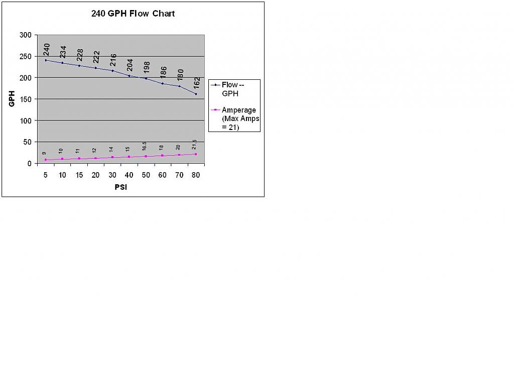

This may have been asked, or even shown before, but do either of the competing companies have any charts that show the flow vs. pressure?
Personally, I'd like to know what each one flows. Everyone say they like their pressure at "x" psi, but I wanna see what the pumps are actually flowing at said pressures.
From left to right: 150 GPH, 95 GPH, 120 GPH (90 @ 45 PSI), 200 GPH (180 @ 45), New 240 GPH pump
