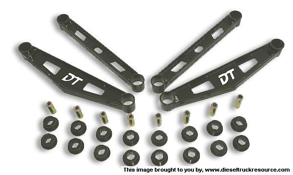

When you're ready to upgrade your control arms, DT Products has some REALLY beefy stock replacements for around $325.
I was gonna put them on my truck but David talked me into test bedding his radius arms.....I'll post more on those soon. The revised design made my jaw drop when I saw 'em (and I'm not easily impressed), just gotta get 'em bead blasted and powder coated.
