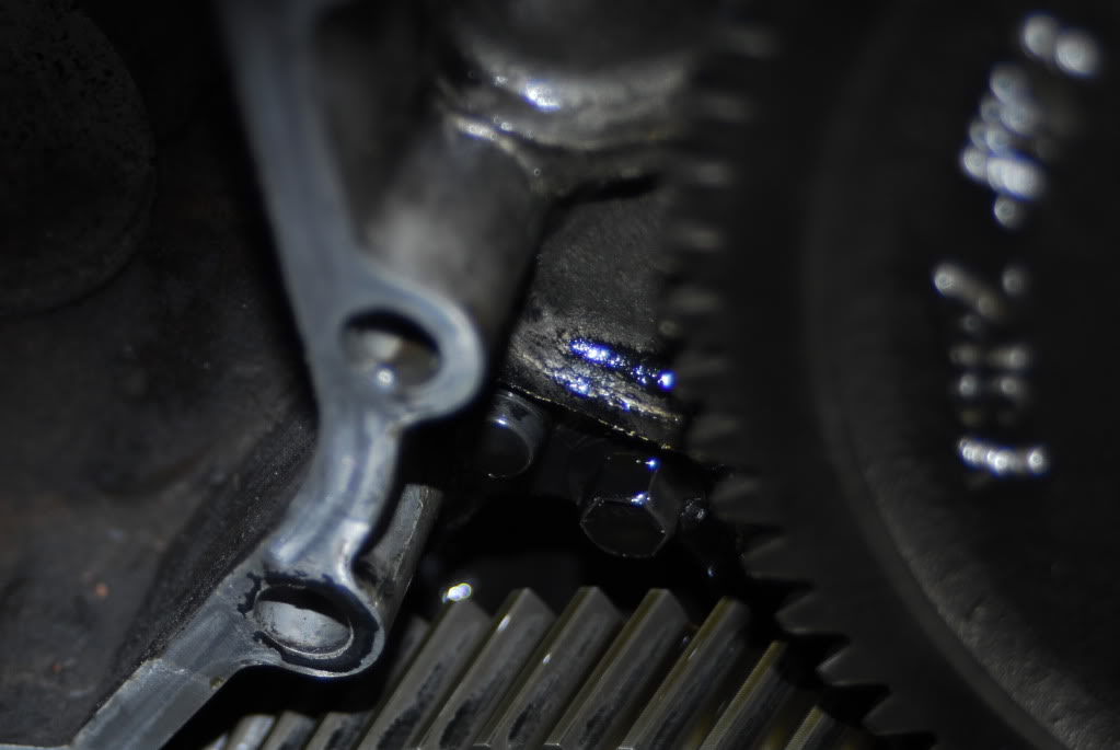

Old Jan 9, 2011 | 09:38 AM
toms73novass's Avatar
Joined: Jul 2010
Posts: 68
From: Grand Island, NY
here is mine at 280k almost out!

Old Jan 9, 2011 | 10:51 AM
runningbird's Avatar
Joined: Apr 2005
Posts: 102
our 94 truck thru it's KDP at 348k. just tab it! you won't like being on a road trip and suddenly seeing no oil pres. because you've lost most of your oil.
