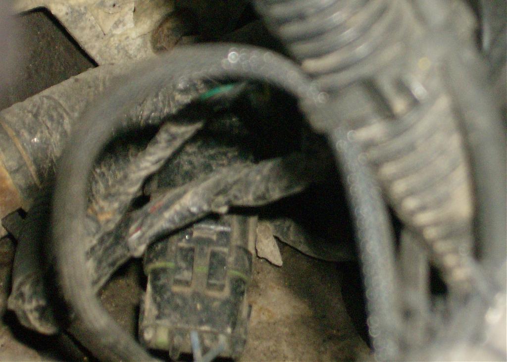

this is crazy. i just upgraded my comp box to the juice with attitude, and do you think i can find the data link connector. right, its easy. sure. did a couple of searches. but does anyone have any picture on where it is or exactly what it looks like. i looked all arround my map sensor wireing, cant find anything. it it capped?/blocked?. in the install instructions. it says "some 2001 trucks the conector is located on the drivers side of the engine in the wireing harness near the powersteering pump." still cant find it. thanks.

Mine was lying on the lift pump bracket with a dummy plug in it.

Look just behind and just below the fuel filter canister. It can be on top pf the fuel filter canister as well.

I found mine when I was putting in my Adrenaline box, On the drivers side at the front of the engine, about four inches below the VP-44 pump.

here are a few pics that might help your in the right area i think your not looking low enough

On my 02 it was in front of the FF and down toward the bottom of the block, just above the oil pan. About in the middle (front to back) of the engine. It had a dummy plug in it for protection.

Destination... thanks dude!!! i found it, crammed in there, under old dirt and crap. ive been looking for hours, haha.. thanks for the images, the first one was the best.
