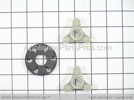

the part should look like this. they only last about a year.
