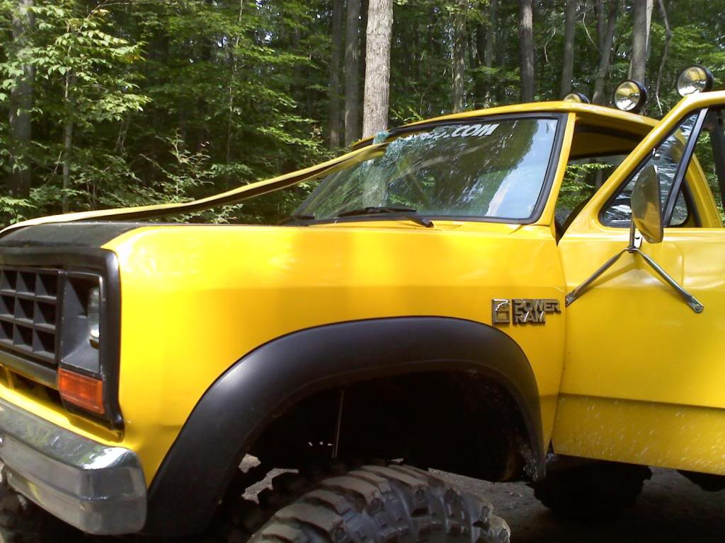

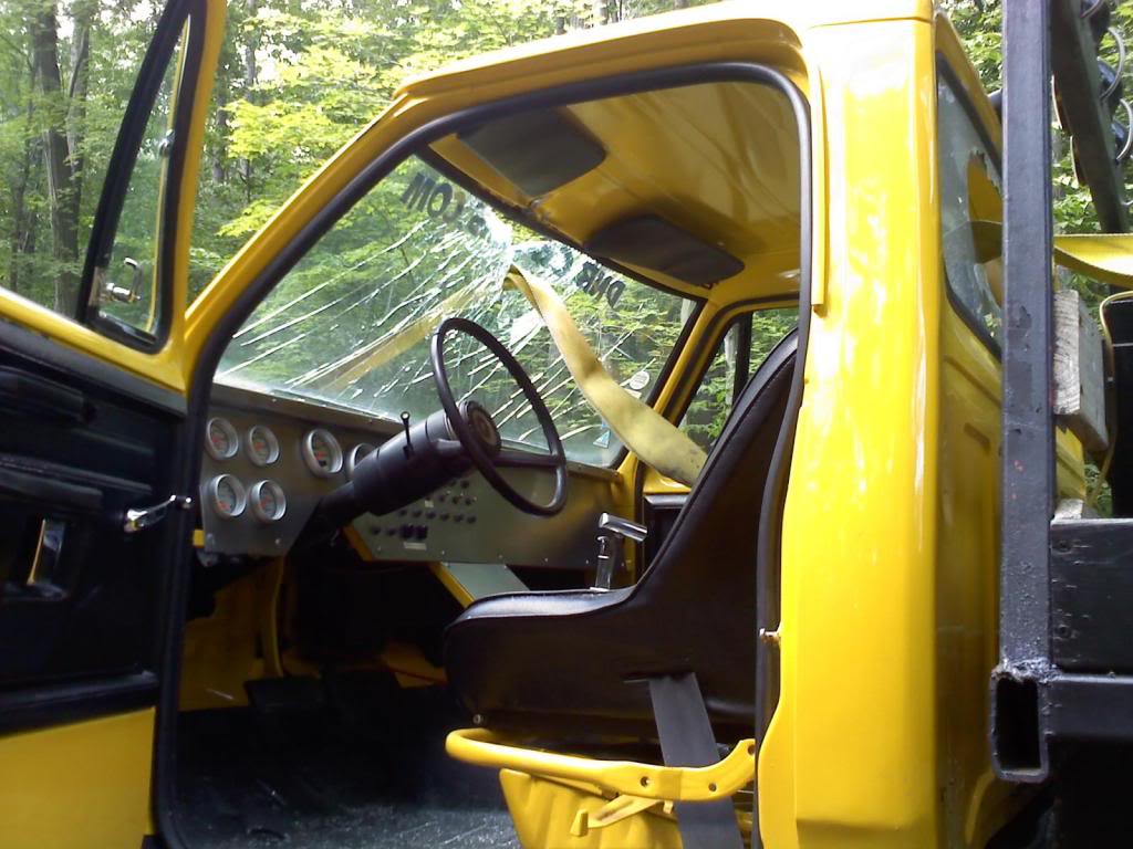

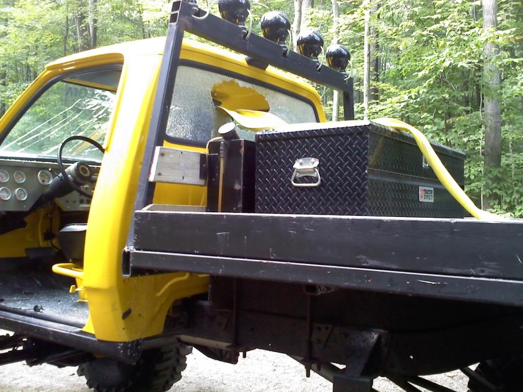

Had a pretty close call today, made me realize that sometimes u need to slow down in life and not be in a hurry all the time. Cause u never know when ur time is up. As u can see a clevis attched to my 6" strap went through the rear window inches from my head and then right through my front window messing up my roof then finally landing in front of my truck...hope this can be a lesson for some...always think saftey when hooking to somthing....Hate to say it but I really needed a new winshield and I wanted a rear slider!!

A bit of expanded metal over that headache rack would be a good idea I think....
im glad you are ok too
and thats why headache racks have expanded metal... id take that as an experience and get some on there

The story goes, had about a 75' cable choked around a stump, underneath and around the top. Then I had my 50' 6'' strap connected to the cable with a clevis. Well on the 2nd yank, the cable end gave way and the clevis slung shot with my strap through my windows and putting a heck of a dent in my roof/drip rail. Ill post a pic of that later, I cant believe what it did to the sheet metal, if that woulda been my head. I wouldnt be here typin this. Im definatly going build something to make sure it never happens again. I will always take my time the next time Im yanking on something good, thats for sure. I might even invest in a lead blanket or something.
