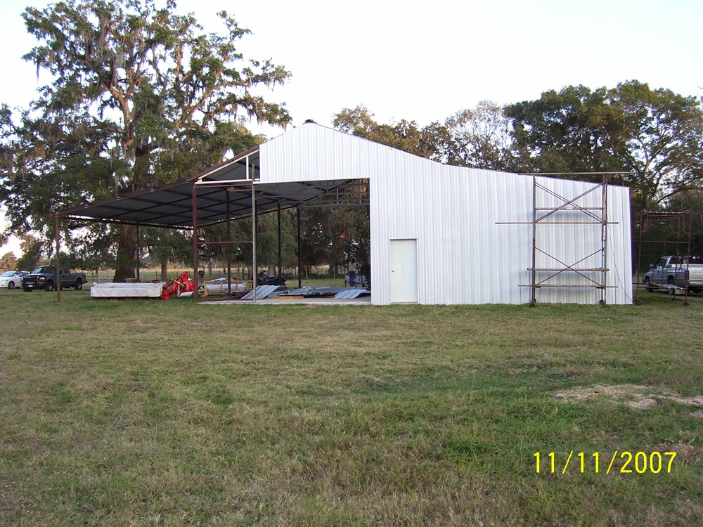

I am almost done building my shop. Its 30x40 enclosed, with a 20' lean to on each side. That makes it 70x40x14' ceiling. Anyway, I am trying to figure out what kind of lights to put in it. Anyone have a good suggestion?
I attached a pic. Since that one was taken, I have closed the rest of that end off, and put on the trim. I still have to put on the roll up doors..
