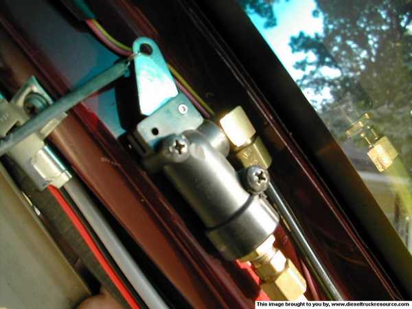

I have a 5 gallon air tank in the bed, air line up to a lanyard valve mounted on the A-pillar, air line down to the horns mounted on the front bumper brace on the passenger side. No electrics. No compressor. Simple. I air the tank up to @110 PSI about every 2-4 weeks.
