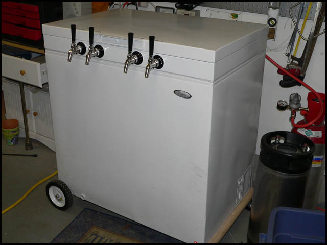

In all instances adding to beer lines solves the problem I had 5 ft lines when I first started and had problems like you are having. When I added more taps I bought 60 ft of line and made them all 10 ft. Solved the problem . The lines are all inside the kegerator so they stay cold. I just put a wood collar on the top so I had more head room and the taps are mountedto it. This way if need be I can just remove the collar and its a freezer again . I use a Johnson temp controller to make it work like a fridge . I don't have a pic of mine but it like this one

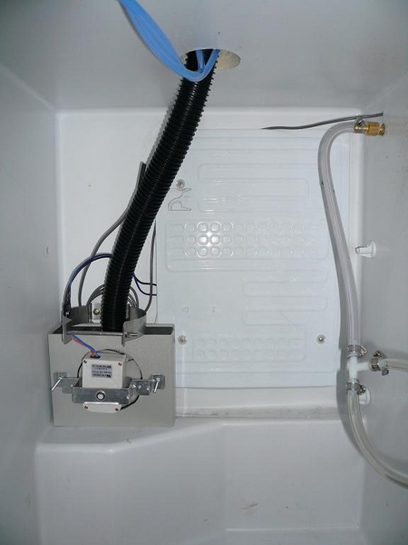

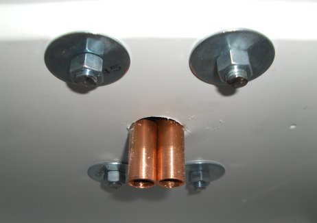

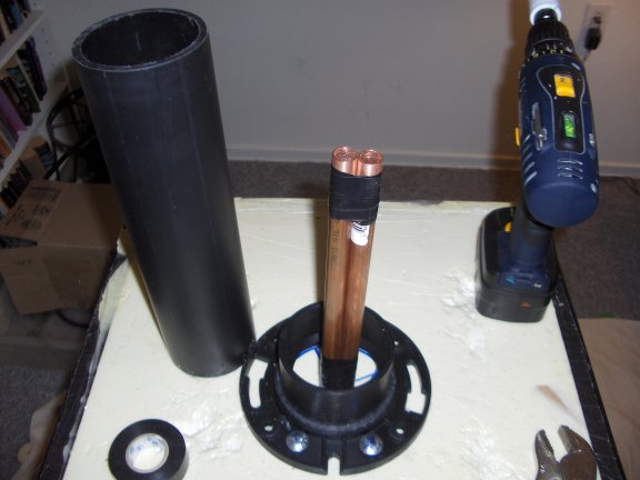

ok there are tricks for cooling the tower . Take a computer fan and wire it up to a 9v cell phone charger and place it with a duct that goes into the tower just a flexable hose. This way cool air is exchanged another way is to take some copper pipe about a foot and wedge it into the tower with 6 to inches exposed inside the kegerator. The copper acts like a heat sink and cold is always drawn to warm so it cools the lines .
