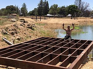

Dock build started today. Stopped after the front cross beam got anchored in, as it got too hot. This evening we will set the fourth beam at bank side, and my son will add two concrete footings in between the two 4x12’s heading out to the pond, to meet span requirements.

Finally, at end of day all the heavy work that my son has endured is done. The last of the 4x12 beams and cement footings are in, main beams all strongly anchored together, all fasteners shot coated with paint. Tomorrow all that left is the 2x12 joists at 16”” on center, and the dock is completed. Not bad, at about 20 hours from start to finished frame.

Dang! Was short 7 Simpson joist hanger brackets, or we would have gotten it done. Will pick those up tomorrow, and probably have an hour left as the woods are already precut and marked.
All in all, from start to finish frame, about 25 hours into the dock. Not bad for a 21 year old, who had never done anything like this. His momma raised him well, lol!
