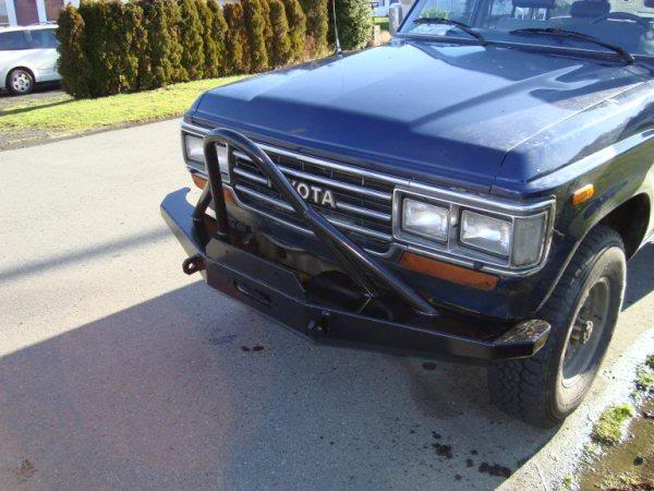

some bumpers that i have built over the past few years...food for thought i suppose
