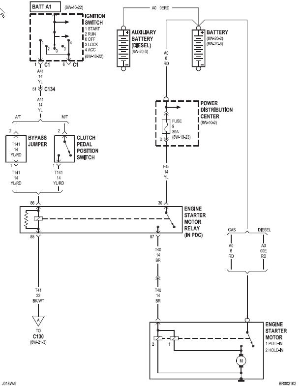

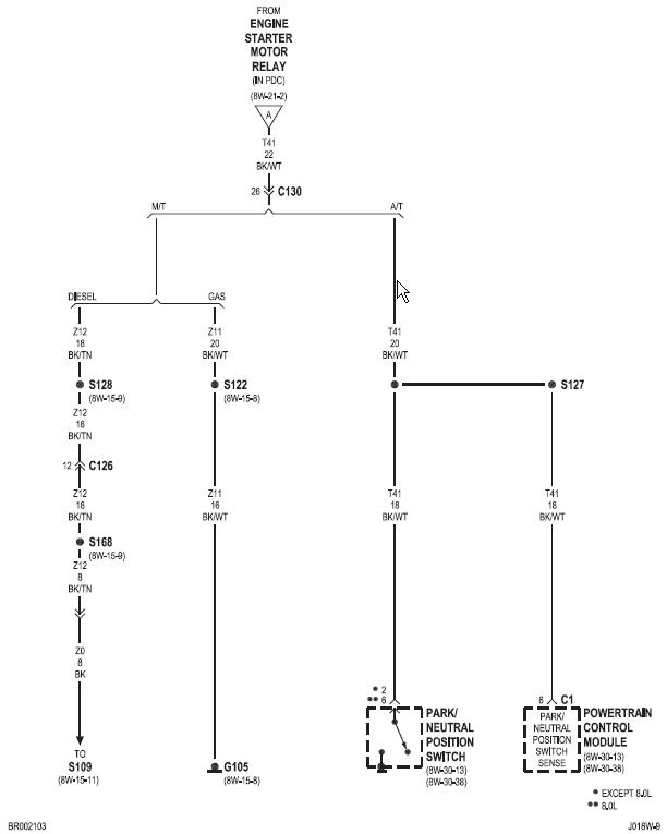

Not sure if the wiring is the same on the '99, but here are the diagrams for the ignition circuit from my '01 FSM.
Looks like you should be able to pull the engine starter motor relay when you have the no start condition and test inputs to that relay to see if everything is correct. Pin 85 should be grounded. If not, you may have a bad Park/Neutral position switch. Pin 86 should have +12V when the key is turned to start. If not, you can check the bypass jumper on the clutch safety switch plug. Pin 30 should also have +12V provided through the #9 fuse in the PDC.
Attached Thumbnails Stuck in el paso-starting1.jpg   Stuck in el paso-starting2.jpg

Thanks for the diag. I tripple checked all my connections w/a volt/ohom meter then...I took the same new starter back to a diff AutoZone, it tested good. They didn't want to swap it out but after convincing them it was the solenoid, they finally did. I reinstalled it, checked everything twice and it fired right up 3x. I would not recommend buying a starter from Auto Zone and wouldn't have done it originally had I known I'd be changing them every two-three years and having added difficulties. Knocking on wood that the issue has been resolved.
