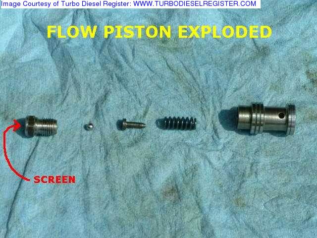

There is a flow piston inside the pressure port on the back side of the pump. It is about a 1 inch fitting. Remove the hose, the fitting, the piston and the spring. Pay attention to the direction and the order. If I remember correctly the spring should be just over 1 1/2 inches long. Disassembling the piston requires a vice, the nut is very tight. Clean the screen with brake cleaner. Flushing can be done using a turkey baster. Refill, run the engine turning the wheel from lock to lock a few times. It is best to jack the tires off the ground to keep from breaking a belt. Repeat the baster/refill thing about 6 times and most of the fluid will then be new. It should be fairly clear.
Could someone tell me how to insert a picture, rather than a thumbnail?
Attached Thumbnails Power steering/brake/?hydaulic assist problem?-sizeimage%5B1%5D.jpg
