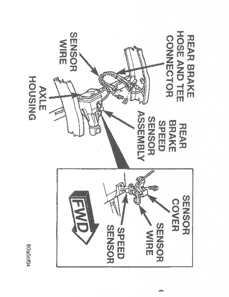

Looks like an O-ring around the diameter, and there should be a bolt straight up and down.
Here is a pic. Also looks like any decent auto parts store should have one in stock.

BTW, it is the RWAL sensor........
