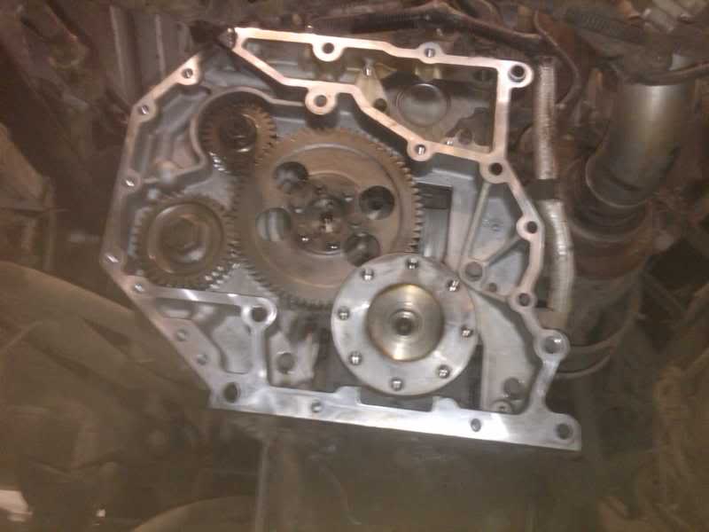

So I did the job this morning. and the engine is a rear gear train ISBe 5.9.....what the hack. I never knew there was a rear train B engines out there. shocked the heck out of me when I was inspecting it. Its nothing like you describe being a rear gear train engine.

the rear geartrain.....

Known facts....... 6 cylinder cummins, 2005 model year, commonrail injection, EGR engine.
CP3 and aircompressor are the 2 gears in the rear housing.

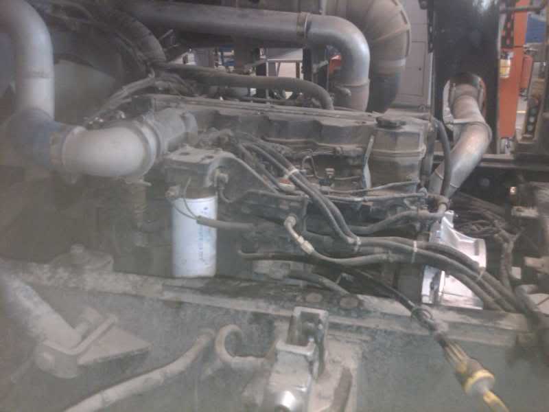

Just out of curiosity what is this thing in? I've never seen anything like this, it almost looks like it is installed backwards.
Old Feb 1, 2010 | 08:06 PM
1-5-3-6-2-4's Avatar
Posts: 3,142
From: Okotoks AB
Its in a 2005 Ottawa Shunt truck........
Not this one, but just like it......

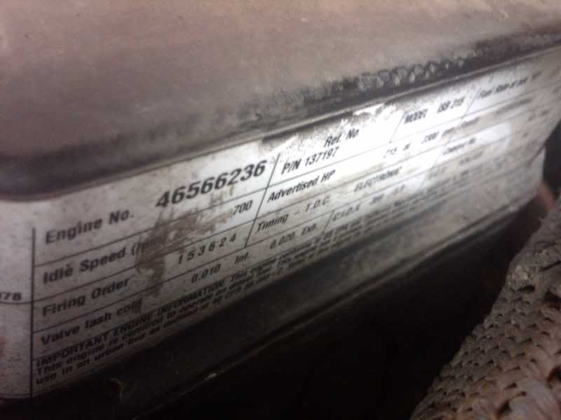

but it says ISB right on it. in the model line on the tag, you can see it in the pic.
*edit* well its kinda blurry there. but it says ISB 215 in the model spot.
