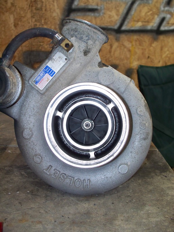

Here is what i mean if you dont understand. You can see the allen screw in the brass elbow.
