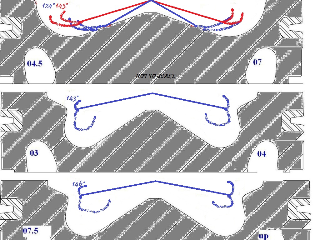

The 03-03 nozzles are 8 smaller holes so it effectively is delivering better atomized fuel in a broader range. Since the pressure is higher on a 600 engine it helps atomization even more. I think they deliver slightly less fuel in that configuration which would track with the mileage gain.
The spray angle is wider on the early nozzles and that may be an issue if the bowl is not wide enough to contain fuel. Not sure on the bowl measurements but if the angle is too wide with advanced timing it will slop out of the bowl and cause issues.
The 03-04 bowls are also re-entrant to roll the air back off the lip and contain the combustion charge in the center where the 04.5+ bowls are not and rely on a narrower spray angle and keeping the fuel in the bowl with angle and timing.
As for the effects, that varies by use. Probably the only way to tell is run with the 03-04 nozzles for a while then pull the head or use a boroscope and look at the spray patterns to see what is happening.

oh no thanks, that is my understanding (limited) after being educated by the membership here on my earlier thread. I was just more than a little amazed by the difference in the 2 nozzles. While some of us want maximum performance others are looking for the ultimate blend between the two and I thought I had found it only to find it was bad for my engine.
