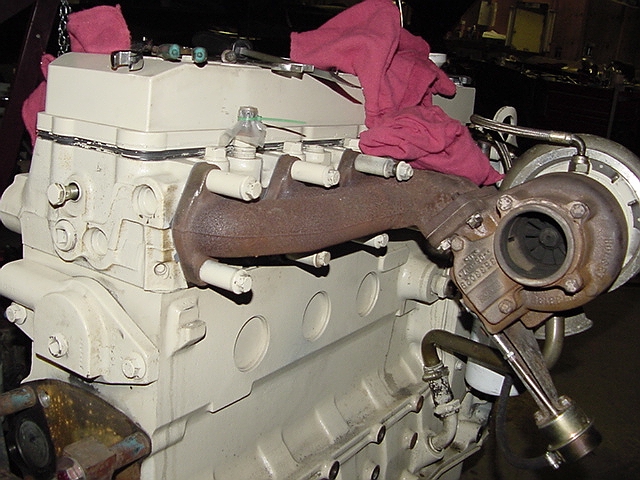

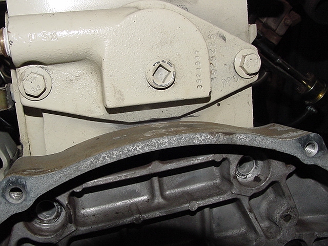

Chris,I have heard of them falling out before,If they(2004.5) are the same block as the 98.5 - 2002 Put a plate in the back with a seal on it ,, Like the water plate that goes on the back of the block, Like this,, I put the freeze plug and this plate,,,
Should be 2 bolt holes back there,,Might be easier to do that.

It was to funny,,We were installing the engine in the truck and as it went by my head on the engine crane I was staring at the freeze plug and had visions of it falling out ,,,,and I had the water plate sitting on the bench,,I was going to sell the water plate later I figured what $20.00 on eBay ,, it's worth the $20.00 to put it on the truck,,,,and I said WAIT lets put that water plate on for the heII of it,,Only had to chop 1/8 inch of the plate for bell housing clearance..That's how it got put on my engine (was on engine when I bought engine)... I think the limited access back there it might be easier to make a plate & Gasket and install it,,Instead of trying to install a freeze plug,,OR you could make a small steal bar to go across from threaded hole to threaded hole to help install and retain the freeze plug.
