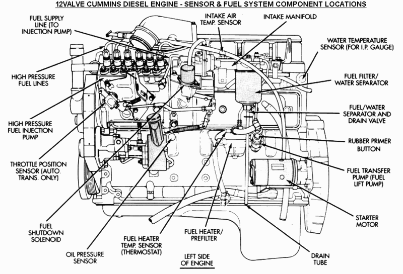

Oh my. If your Wal-mart is anything near what ours is like, I'd run, not walk away from it. Yes, there is a lift pump. On the drivers side of the block. If it we're me, I would start this process with a fuel pressure gauge. Get one that goes up to 30 psi and you'll be good. Follow the fuel line from the tank to the engine. You'll run into the lift pump eventually. After the lift pump, get your gauge put on it. You'll need 15 at last at idle and never should it ever go to 0. If it's a factory lift pump, I'd be surprised. If it's weak, it's not gonna want to prime very well. I'm betting that's your issue and/or an air leak in your fuel system somewhere.

You likely still have a fuel line cracked, allowing the pump to de-prime overnight. The easiest way to verify this is to not drive it for a period, sufficient to normally cause it to be a hard start. Then, before you start it, lift the hood and on the drivers side of the engine block, towards the bottom, you will find your lift pump. It MIGHT still have the black rubber accordion boot over the prime button, or it might be like the rest of ours and just have a white plastic hollow shaft sticking out. In any instance, this is how you prime the IP. Take a suitable implement ( I like a common garden hoe ) and use the end to push on the primer until you hear a hissing, or a singing sound. This will mean you have primed the IP. Mine usually takes just 10 or 15 strokes when I have had a cracked line, just keep pumping until you hear it hiss.
See if she doesn't start right up. If she does, then you know you have an air leak somewhere, usually in the return lines.
That's a relatively easy fix, lets diagnose it first though.
