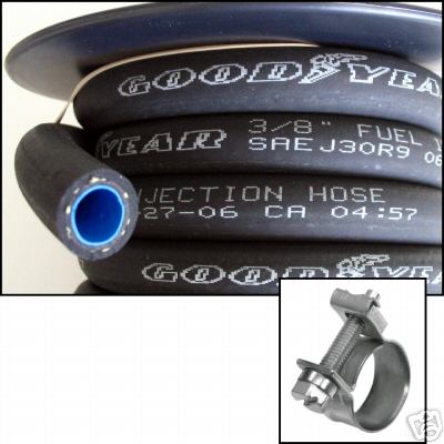

Thumbs up AutoZone
Originally Posted by rebal
can someone tell me where i can buy the High quality fuel line used in the fass fuel pump kits I need 5/16 and 3/8 so i can rip all the steel line in my 97 ?. thanks
AutoZone,,Goodyear hose,, Black on the outside blue on the inside..
