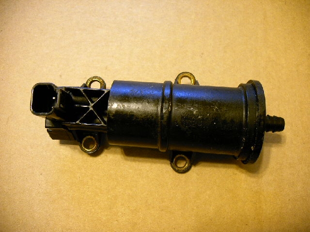

Looks like a dead CARTER/FEDERAL MOGUL Lift Pump
Anyone happen to know the voltage I should be seeing with my fluke meter at the LP harness... always wondered how much voltage is fed to the LP(?)
Old May 27, 2009 | 08:46 AM
xxwildbillxx's Avatar
Posts: 316
Likes: 6
From: Illinois
Looks like its gonna be a few weeks for a warranty replacement pump to arrive from autopartswarehouse
If anyone has an original/stock LP lying around you wanna part with, please let me know, maybe we can work something out?
