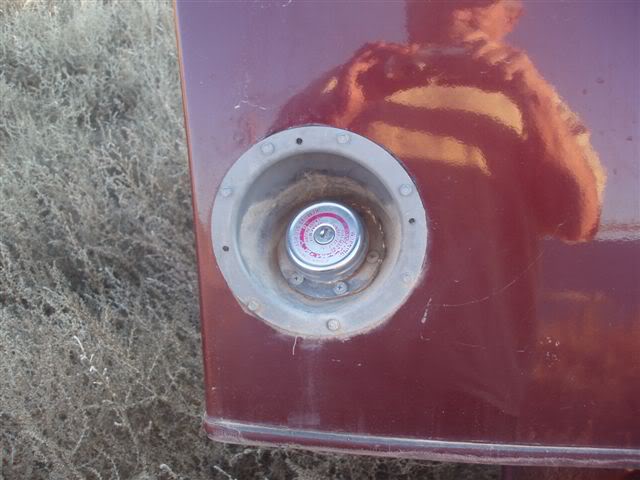

Originally Posted by jpl
First and foremost, I promise I spent about 30 minutes searching so that I wasn't asking one of those "same old questions".
I am wondering what my options are for filling an auxillary fuel tank with a topper installed on the truck short of backing up to the pump and climbing in the bed?
I'm wanting to install a small tank in the bed and use the gravity fed method to the main tank, but am hopeful that someone has come up with an ingenious way of filling that tank. I'm sure I could use a hole saw and plumb some type of filler neck through the window of the topper, but I think it would look awful.
Any ideas?
how does this look?
