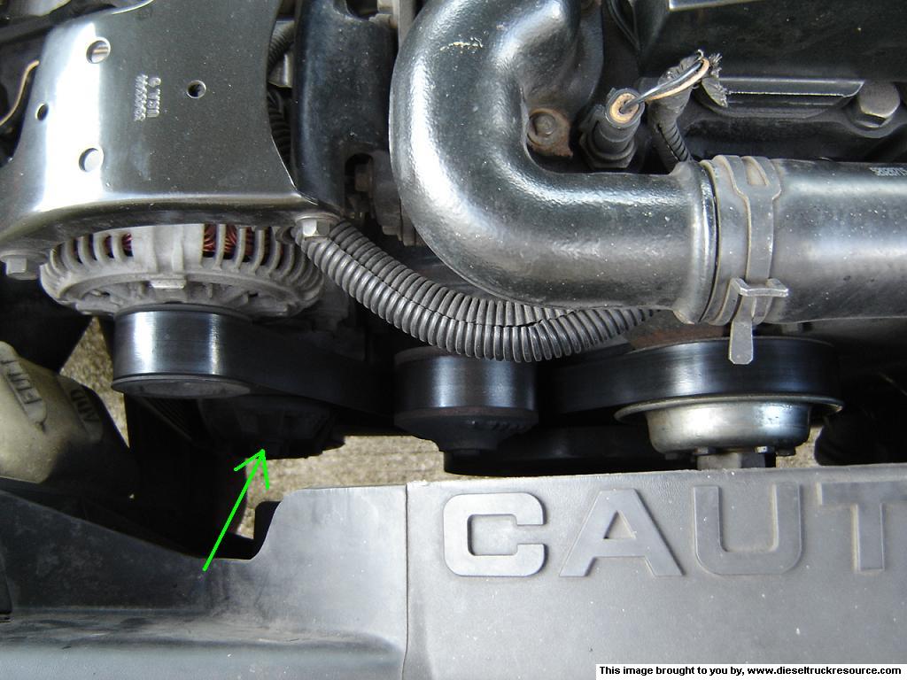

You have to first release the belt tensioner. You use a 3/8" socket wrench (with no socket on it) or a 3/8" inch breaker bar. Insert that into the square hole on the tensioner and rotate it to release the tension on the belt. Now you can remove the belt.
While the belt is off I highly reccomend you use some emory cloth or very fine sandpaper and rub all the pulleys. On the ribbed pulleys get in the channels with the emory or sandpaper. The point of doing that is that the only thing that drives your pulleys is friction. As belts get older they tend to slip a little more and more. As belts slip they have a polishing effect on the pulleys (called glazing). Roughing them up will restore the surface and give the belt a much better surface to grab onto as it rotates.
Here is a picture I just took. I highlighted where the tensioner is (green arrow). It sits between the alternator and the A/C compressor.
