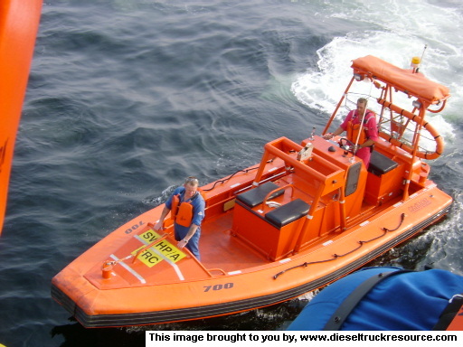

This is what we use in several of our small craft out here. Our FRC (Fast Rescue Craft) uses a single with a Hamilton Jet Drive. It smokes along pretty good. I've been able to catch some air with it before in mid-sized swells. (I mean I've heard of this happening to people before) These are built in Alabama and similar too what the Coasties use.
