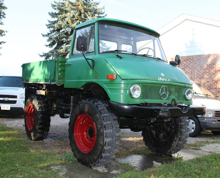

I am thinking of adding a turbo to my unimog to help driveability issues, I figure I might be able to get some help here, the theory is the same.
A 5.6L inline 6 diesel mercedes om352 engine is naturally aspirated and makes about110 peak horsepower at 2800rpm. The pump can be turned up for a bit more power and the governor adjusted for more RPM, but it will raise the EGT too much for what I need, and EGT gauge is mandatory as it will run close to 1350 fahrenheit. Originally it did 75kms with stock engine at maxed at 2500rpm, new engine is governed for 2800 rpm, can do 85km/h. I have new tires for it, the larger tires installed will also rob more power, which this 8000 pound truck cannot afford but will increase my top speed to a theorethical 99km/hr, more if I up the governor and pump. For prolonger full power use like driving on the highway, adding a turbo will add more air and lower the EGT if I understand correctly.
How much boost could a diesel engine take before more fuel is needed? Is it like a gas engine, where after x-amount of boost the air mixture is too lean and would get hot again? Is there a "happy zone", boost that a diesel engine would like? I know some of the dodge cummins engines run crazy boost to make serious horsepower, I dont want to go that crazy, I'm strictly interested in prolonged high rpm use, the drivetrain cannot take more than 200 hp without a lot of work

Unimogs are amazing- that is a nice looking truck you have there.
