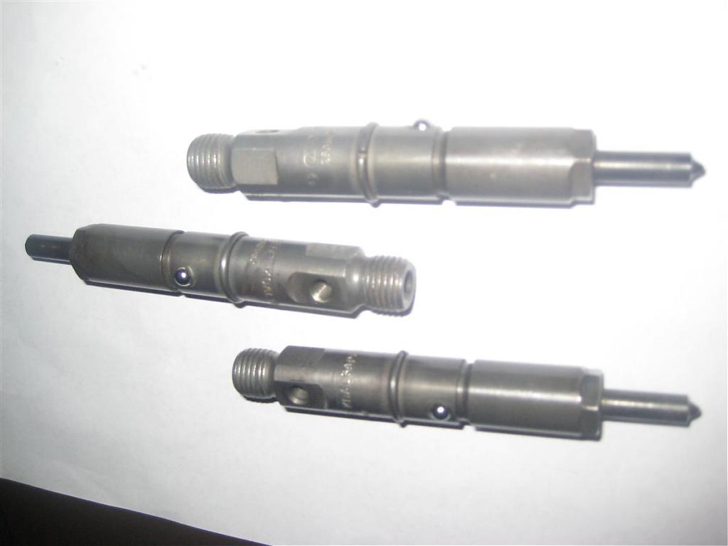

I got 6 rebuilt injectors for free and i'm trying to figure out what are they actually.
markings on it are as follows:
939 circled
KDAL59P6 561
6819

Can you take some pictures of the injectors so we have a place to start? If we can get an idea of what they look like we will have an easier time getting the pinned down for you.

here is a picture of them
They have 5 holes on the nozzle

12 Valve maybe??
They look like these:
http://www.scheiddiesel.com/display_part/744.php

i have a set of 6 215hp injectors and i went and looked at one it has
0325 by the line threads
939 kdal59p6 569
260 bar

Pretty sure they're for a 12 valve, can't really tell off hand if they're for VE or P-pump style. Check threads and pitch on the fuel supply side to determine that, then get the injector holes measured. As for who made them, I really don't know how to go about finding that out, other than to call II, scheid, DD, and some of the other companies that produce or deal heavily in injectors and tell them how they are marked, they may be able to help you track down what they are.

Are they 7mm tips?
