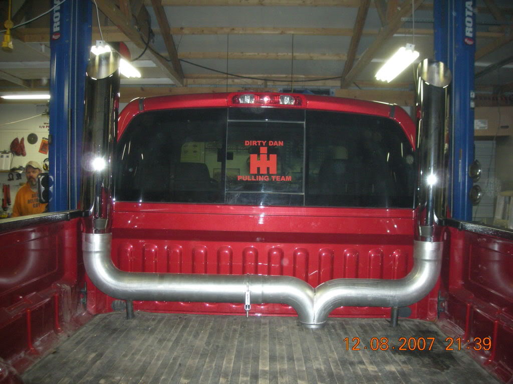

I used some scrap pipe to put a brace off the bottom of the crossover tube and them bolt it to the bed, you can not really see it in this pictures, but you get the idea.
