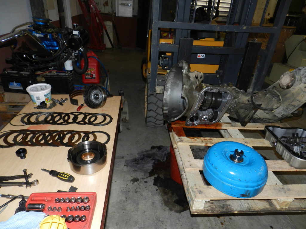

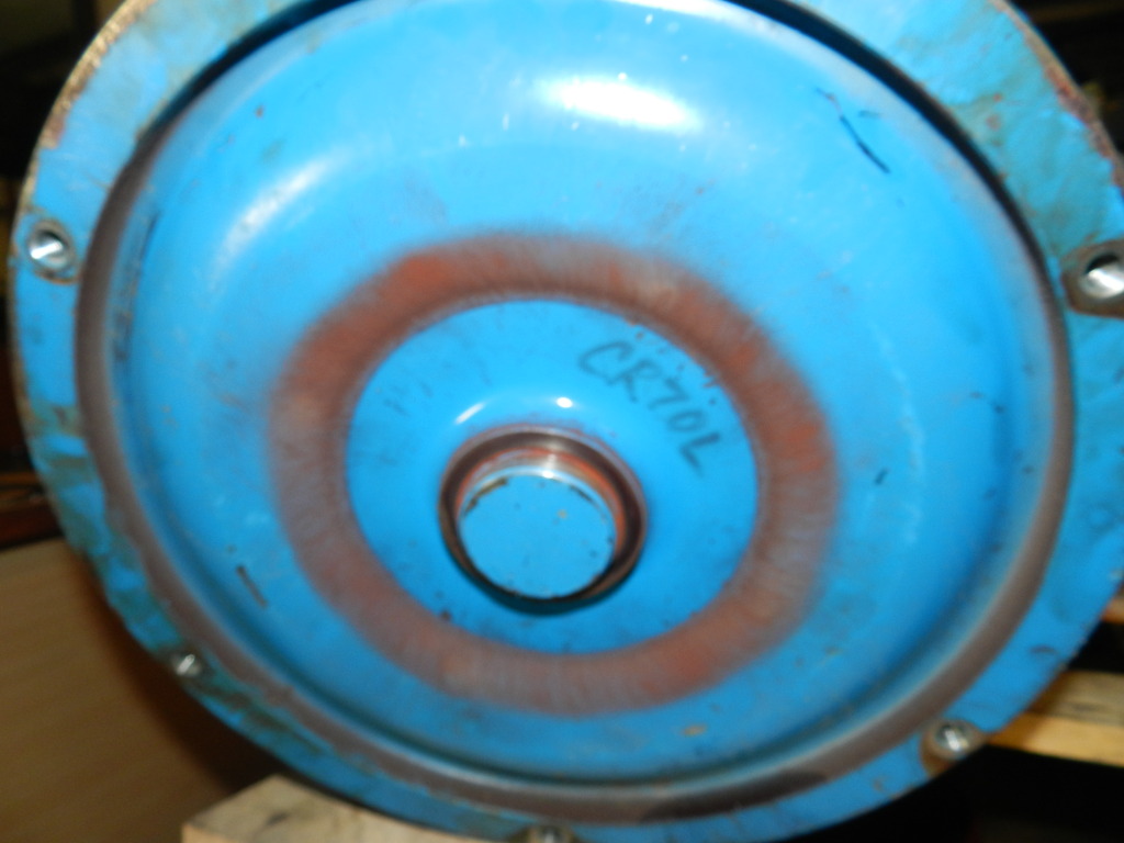

Hi everyone, I just want to post up my recent dealings with DTT. I want to state the facts and hopefully people who want to do business with them will be very careful, because I don’t want what happed to me to ever happen someone else. (Which it did)
So to start off in November 2010 I bought parts to overhaul my trans so it can handle a little extra power. Bought some parts and their $565.00 "billet single that can handle 500hp 1000lbs torque... Now back then you didn’t have to wait months for your parts and I received everything in a timely manner. Installed the parts myself and had a decent tranny, was never quite happy with the shifts but whatever, truck was down for a month and I was happy to be driving it again.
Now fast forward to June 2012, truck was running higher rpms than usual, emailed DTT but no reply for days, when I did get a reply it was a rudely toned email from shanty saying pretty much we can’t help because we can’t see or drive the truck... So because of that great customer service, I still needed answers so I went on Cummins forum and started a thread where DTT was quick to reply but still no answers. I took the troubleshooting into my own hands removed OD, found clutches a bit burnt, no material removed or warping of steels but still things were slipping. Replaced them, put it back still no change. Later I swap valvebodys but no difference. Now I’m scratching my head. I called up local tranny guys and they said sounds like the convertor; I was like no way is a performance one and I got like 23,000 miles on it. Well I took the trans down opened it up and the clutches inside were perfect. So I put everything back and swap out the convertor with my old one which has 212,000 miles. Guess what my truck working fine again. So without a doubt my convertor was the problem. Also all my findings and pictures of the transmission internals were posted up for everyone to see.
So now I was happy that I know the problem but angry at the same time because the convertor is no good. So I noticed a number on it and goggled it, only to find my "performance" convertor is nothing more than a stock convertor with billet front cover. Which is good for 550 lbs of torque as stated by the manufacturer which is transtar (which i now know because DTT always claimed making their own convertors), so I guess the HP rating on that would be about 250, which for a common rail is too low.
I post the info on the forum, DTT says that just a generic number and not to worry about it. They tell me to send it back to Washington State, so it can be cut open to verify what I got... What kind of BS is that, I need to pay to send something back so they can see if I got the correct part in the first place!!! I also state how can a company like transtar track their “custom builds” if they all have a generic number on it. I mean this number is handwritten after the convertor is built, welded, and painted, so if they did something special it won’t be so hard to put a special number on it.
At this point without a doubt I have been cheated, and how can I trust these people if I do send the part back? Once it’s in their hands they can say anything, heck they can even say I got triple disk and who is there to say otherwise... Now DTT even says send it back and they will credit the 565 towards a triple... That seems like a fair offer, but these are just comments on a forum, which is not a contract and not binding. Another important point is that I am in Belize (Central America) so I can’t just go to the ups store and ship it where they want it... This is why I’m sure they made the offer because it out of my reach and would not be a cost effective solution to my problem. Also, up to today they have still never officially made me that offer.
The worst part about this is the thread I had going on Cummins forum is now gone… Someone tell me why would this thread be gone if someone wasn’t trying to cover up this mess and hope it goes away. They have people bash companies with no proof at all, but their thread is still there... Usually I let things like this go because I have better things to do and basically DTT is not worth a second of my time... However, because of the way it was handled I will take this matter as far as it needs to go until I have satisfaction.
To add to this, I have someone in Canada who bought the same convertor one month after me and guess what it failed just like mine. Dtt told him they could do nothing because he was past the one year warranty, but actually they are warranted for 3 years. This guy is equally angry as I am. Also why didnt DTT make the same offer to him like what they did to me?? He will also take this matter as far as it needs to go.
To anyone who has this convertor be careful because it also destroyed other parts of my transmission..

Spec sheet on the convertor
https://esource.transtar1.com/Bullet...00706dwp01.pdf

Not sure if it makes you feel any better or not but I had a transtar converter that looked exactly like that marked cr70x that lasted over a full year, bought it right from transtar for like $350 usd and they list it as a billet front, lower stall converter good for 300hp/650tq. Held up alright for a while, went to the scrap yard for about 3 bucks last month.
