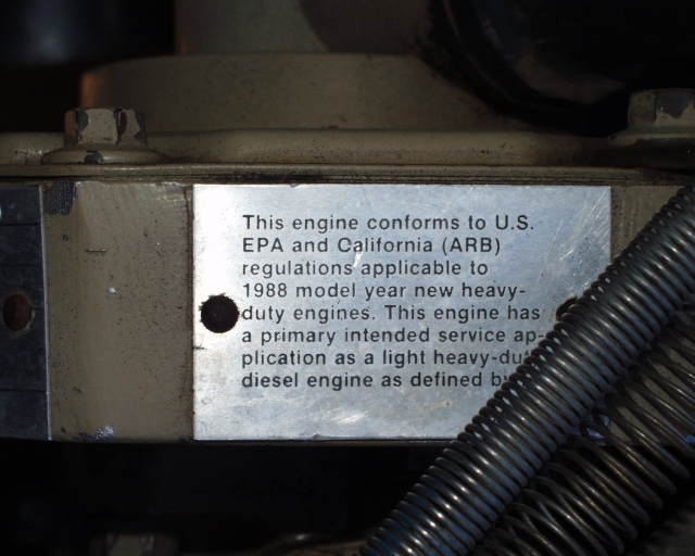

If the engine is for automotive use it will have an EPA tag affixed to the engine. (see picture below)
If the seller is unable or unwilling to provide any of these items or tells you that they aren't needed, is probably misrepresenting the engine.
To me the Craigslist 4BT looks like an industrial engine. I don't see an EPA tag. If it turns out to be an automotive engine, it is missing a few parts like the accessory drive for power steering, the starter motor, the crossover tube, and maybe even the turbocharger. Those parts can set you back $1000+. Heck, it might not even be a 4BT (T= Turbocharged). You can get a good used complete cutout engine from a salvage yard for $3000 or less.
Example of EPA tag
