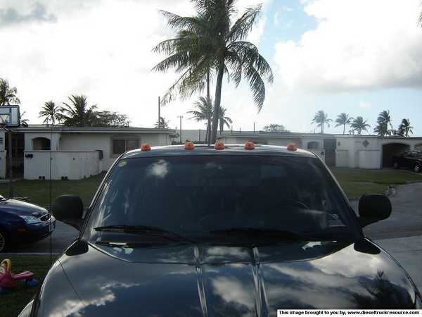

i just did mine last weekend.Very easy to do. The pics kinda blurry but you get the idea
[IMG][/IMG]

I installed a set on mine in in February 2007. I bought the Mopar kit that came with everything needed. Took me about three hours total. One of the biggest challenges is getting the headliner out without bending or creasing it. If you have any questions about the kit or installing it, just ask.
Here are some pictures :
The items pictured here (top to bottom) are the template/instructions. The small bag on the left just below the template hold the bulbs and the screw anchors. Next is the wiring harness. The bag on the right holds a few zip ties, replacement electrical connector,and bulb sockets. At the bottom are the lenses.
I didn't stand at the dead center of the truck for this shot, which is why the lights look offset.
