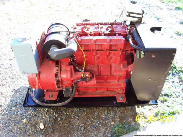

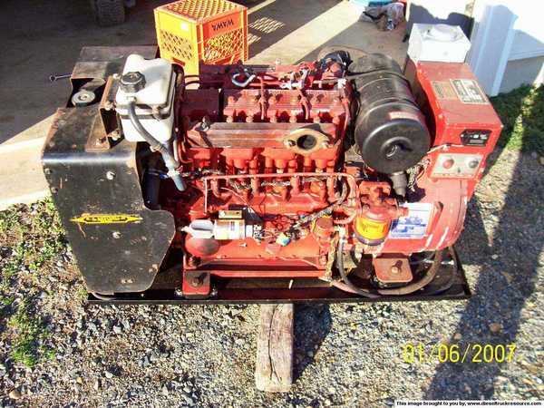

Old Jan 6, 2007 | 05:59 PM
spitfire9137's Avatar
Posts: 312
From: Rising Sun, MD
Pictures......
