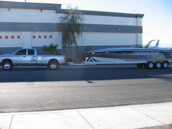

Here's a pic of what I've towed plenty of, hopefully no more of them! I've destroyed my original 6 speed at 129k miles, Haven't had to good of luck with rebuilds after that, seems no one know what they are doing with them!
Have a exhaust brake and at 197k miles I still have my original brake pads at all 4 corners! And yes the rig is "bombed"!
