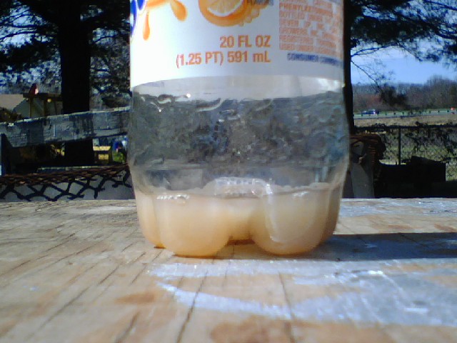

heres a lil bit of it that i drained from the filter
If what you put in looked like that, I'd be very afraid you got a load of water.

AkTallPaul's Avatar
Posts: 277
From: Delta Jct Alaska
Looks like contaminated fuel to me.....did the water settle out? You can get some stuff that you put on a stick an dip fuel tanks with. It changes cooler in water, can't think of the name of it OTMH.....
