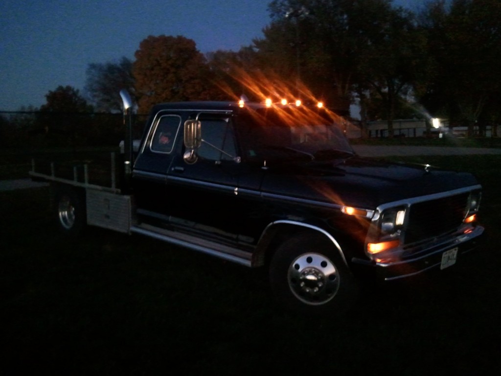

I took the wife to the park so she could walk around the lake the other evening while I was waiting I couldn't reseist had to take a picture not the best.

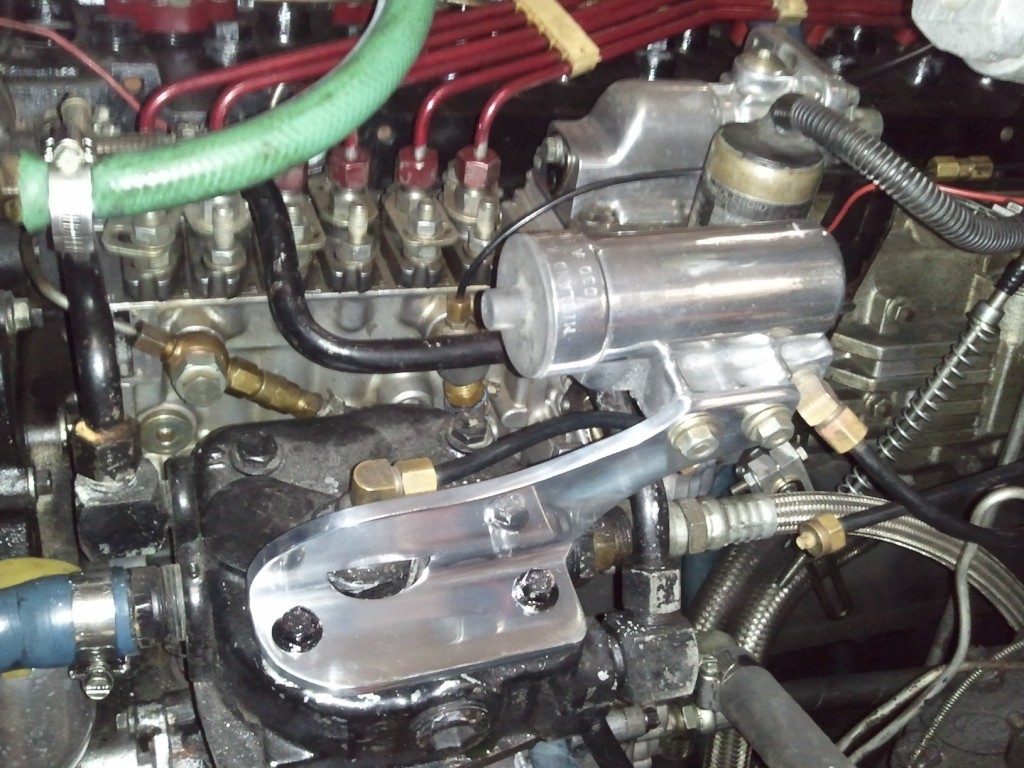

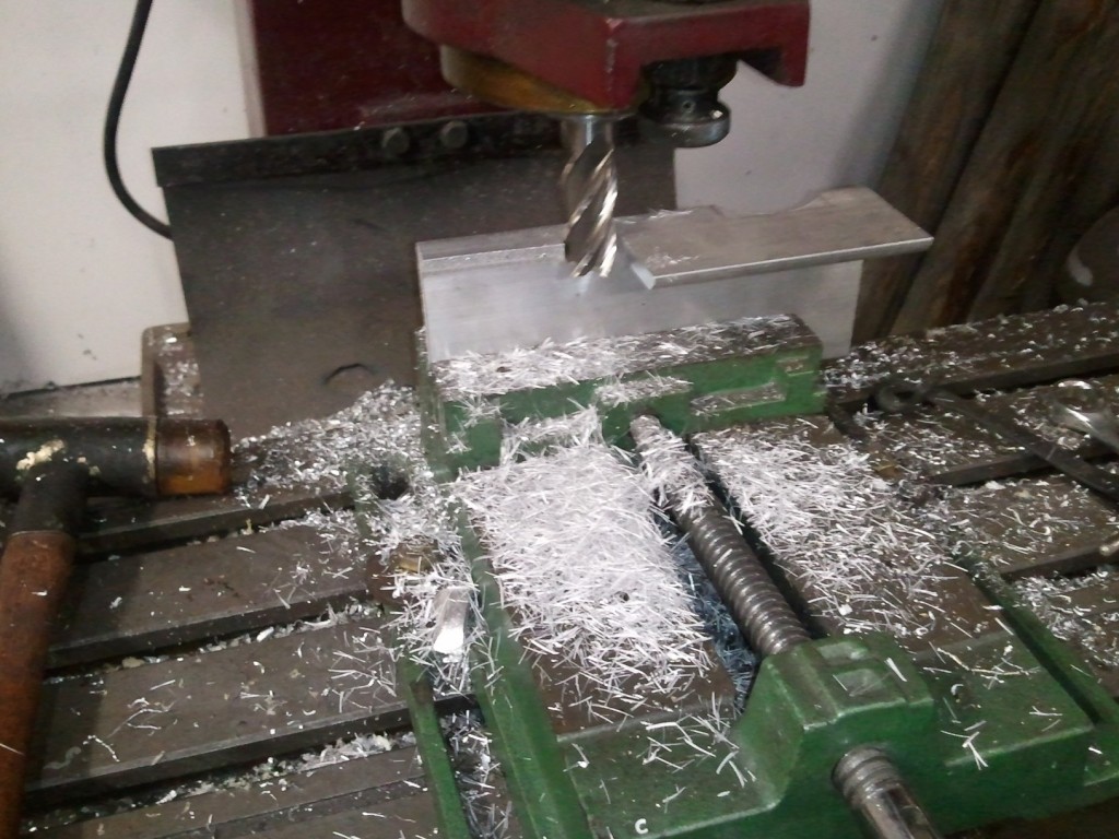

Update had to have the pump and injectors checked out the gov,was messed up.makeing the rack to jump vilently back and forth.the reason I had them check is The motor develuped a uper end knock would come and go.just got it running last sunday havent driven her yet but the motor sure does idle alot smoother.Thanks to Kevin at northeast deisel for doing a great job and a fast repair.

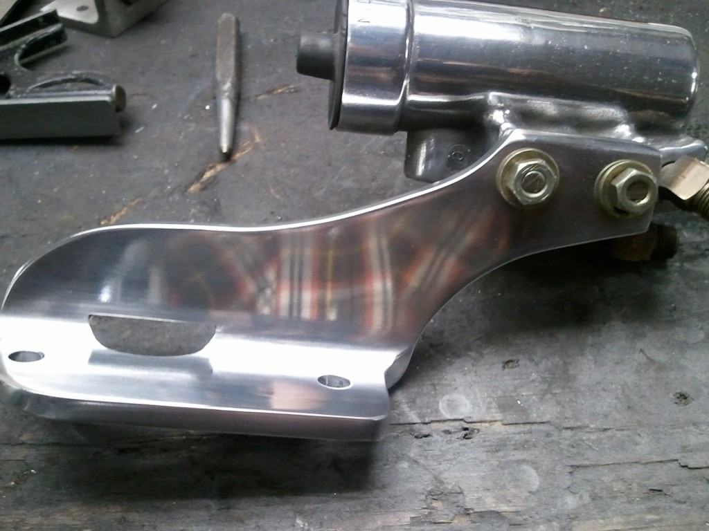

Had to make a new bracket for my gov,for the air compressor the motor shoock badly at idle for about 80.000 miles I just thought it was the motor.Now it feels like a new truck again hoping the knock is gone pulling it out of the garge in the morning.some pic of the new bracket made it out of a peice of scrap aluminum angle.
Dale

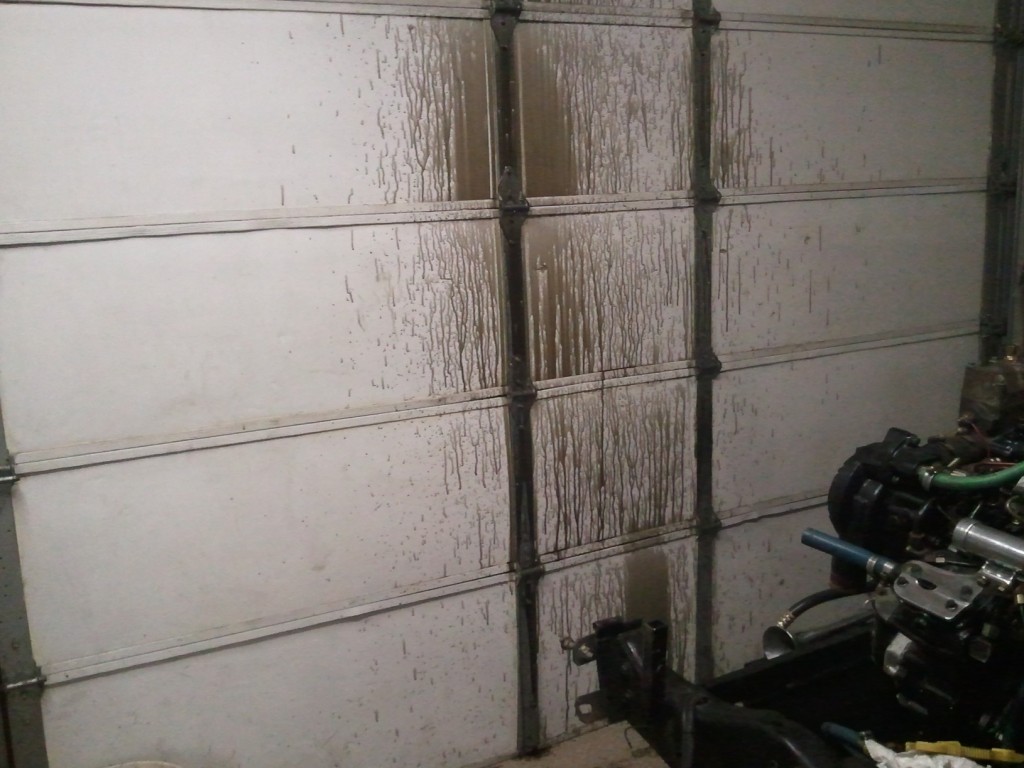

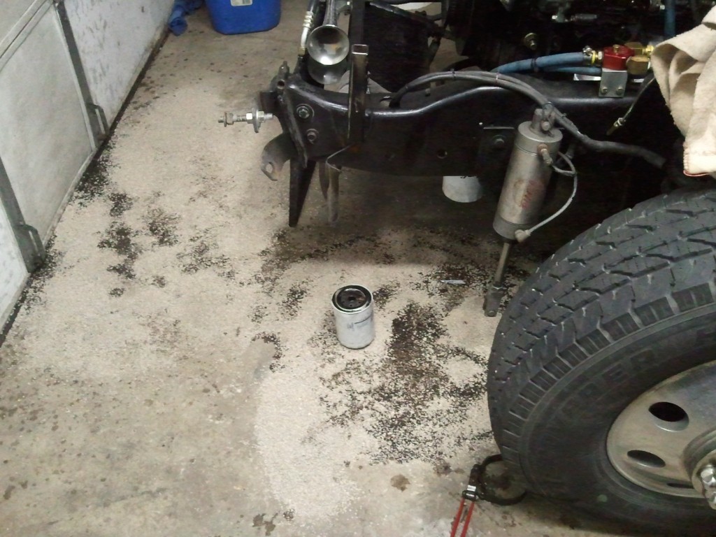

Got her running alot easier than the last time she actully started on 2 cyl.when I got 5&6 bled I had to husle to get the rest of the lines tighten.i had my remote starter button let it idle for a min,then I took the rpms up just a little the hell broke loose oil shot all the way up my garage door to the cealing a he-- of a mess blew the rubber O-ring on the remote oilfilter.by the time I got her shut off there was about 2 gallons of oil all over.
Put a new filter on and put some more oil in started it up while I was in the cab took the rpms up to 200rpms off idle oil pressure went to over 100 psi almost to 0 have to pull the pan and look at the oil releif valve.

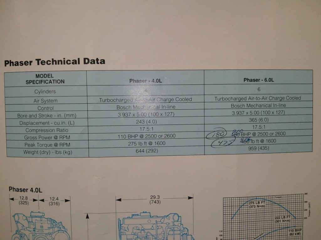

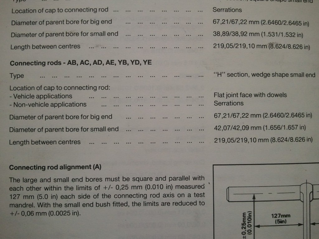

Some pictures of the paper work I got when the motor was new

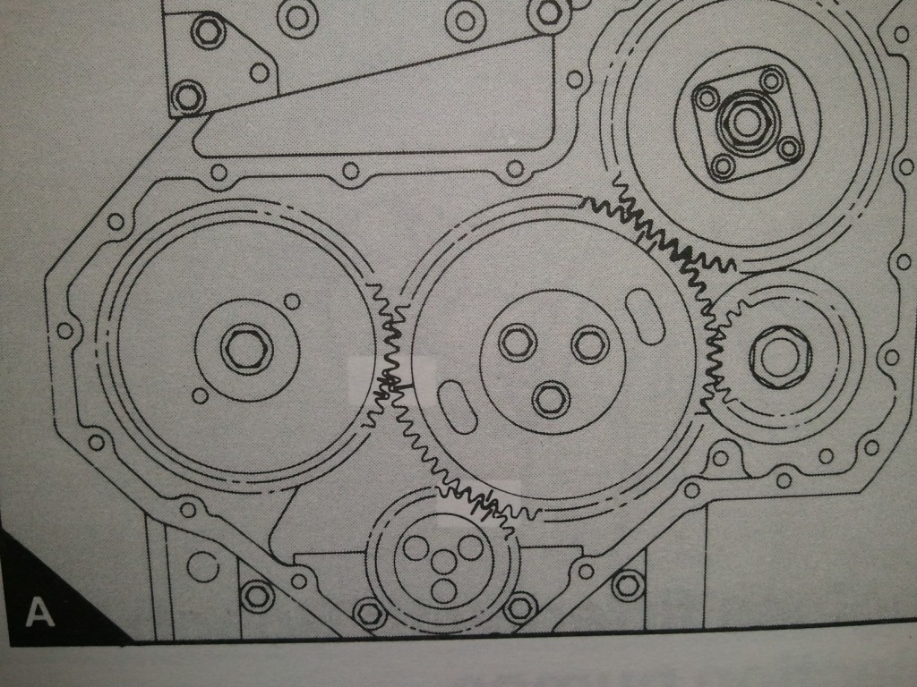

Showing the front gear case

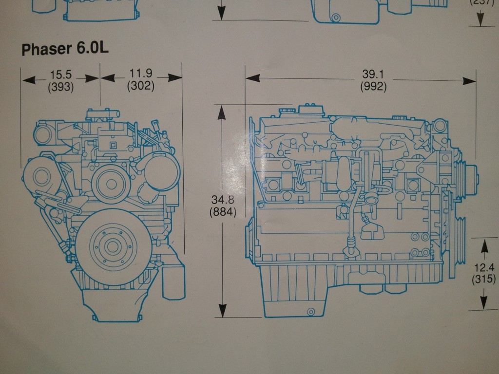

Spec, on the crank
Dale

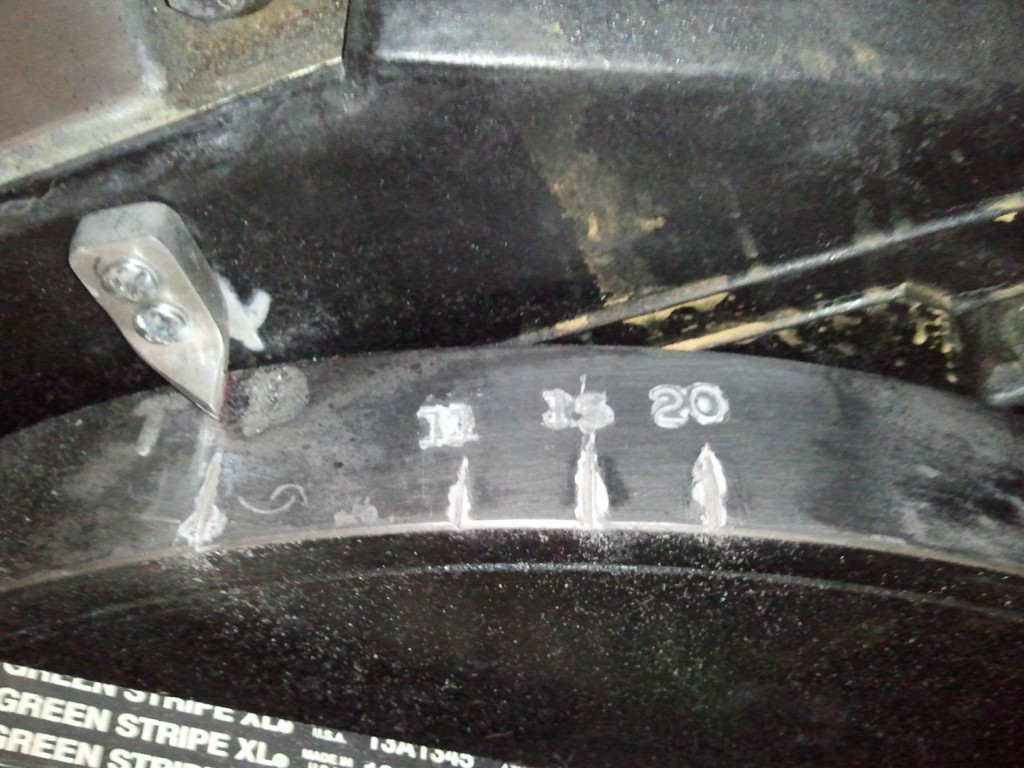

Finally made a timing tab and stamped the palancer insted of releing on paint

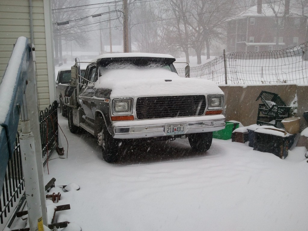

I got the truck out to take her for a test drive 8:30 friday morning made a trip across town then took her out on the Hwy I think she new she wasn't going back in the garage when we were going to get back home We got 3miles out of town and I pulled over to check things over under the hood for leaks didn't find nothing chut the hood and took of agoing and got about 200 yards and no throtlle pulled into the airport road raised clip and the cotter pin cam out of the throtle linkage I din't put all my juck back into the bed box I finally found a paper clip in the mean time it started to sleet and snow like I haven't ever seen come down that fast.Got home parked her on the street so I could get a 08 Ford in the shop to put exhaust and a H&S programer in.I don't like to leave the truck set on the street to many idiots don't know how to drive in the snow.I looked outside about a hour later there was 4" on the ground already.Truck ran good and has a differant tone out of the stacks.Sound deaper.
