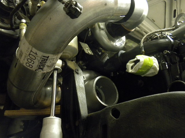

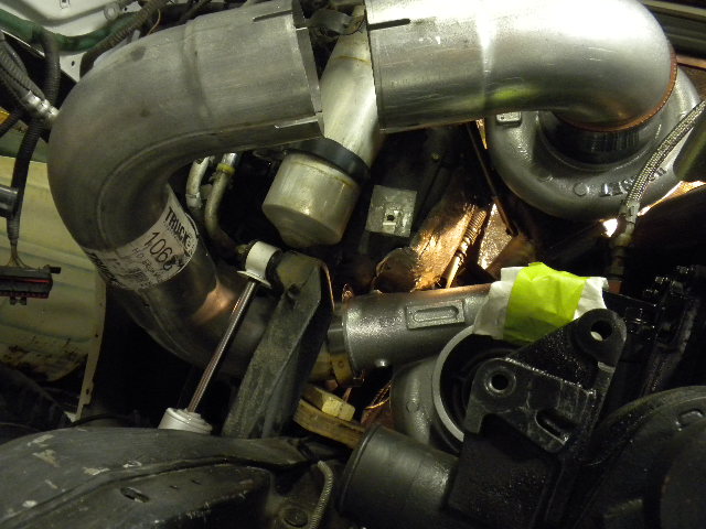

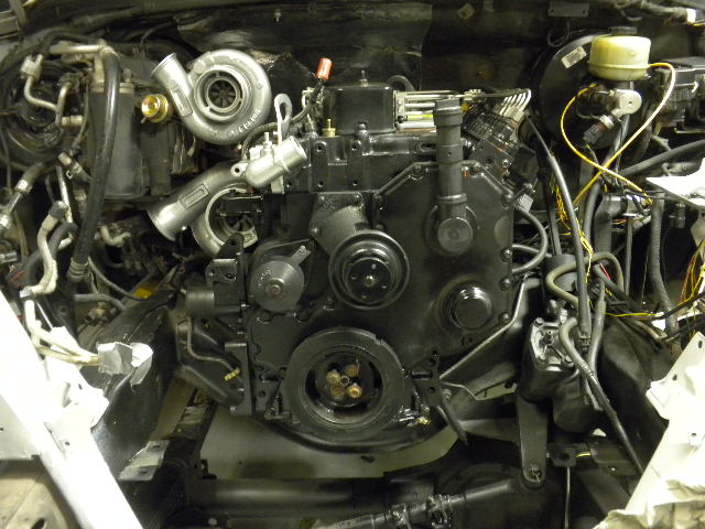

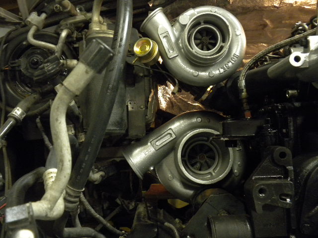

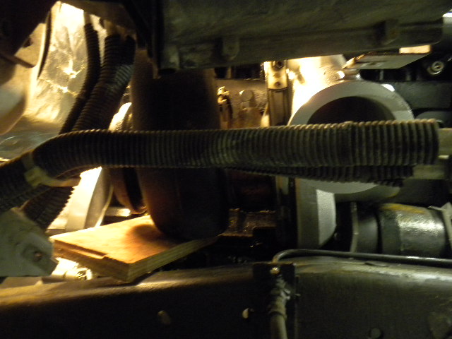

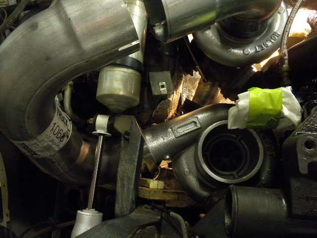

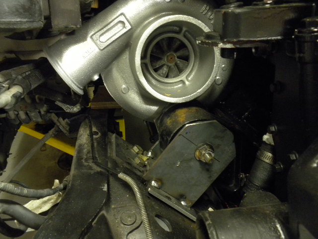

Here are some more pictures, got the engine in, had to move the trans back about 3 inces from stock location. For mounts I had to use 2 right side stock dodge mounts, and made frame brackets. Need to finish welding and renforcing the mounts. The turbos are going to be alot more work to get in there than what I thought they would. When there is no engine in there it looks like there is a kinds of room. The AC box is really in the way. But I will work around it. I have the turbos sitting in there close to where I think they will work.

wow man thats really a tight squeeze! i thought i had a bunch of clearance problems!....hang in there brother....you'll figure everything out....twins are so cool! keep it up!

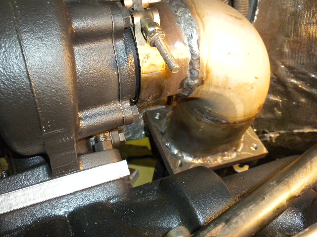

Got the hot pipe made up, working on the cold pipe, almost done.

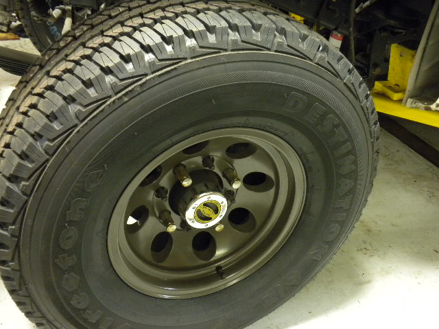

I installed a Superlift 3" lift. It had a 6" lift on it when I got it, but that's too much for towing. 305/75-16 Firestone Destination A/T tires.

I like these tires. I have sold this model of tire to some of my customers and they really like them. Wear good and excellent wet and snow traction.

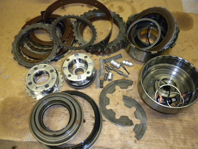

This is the parts that were replaced when rebuilding the trans.
