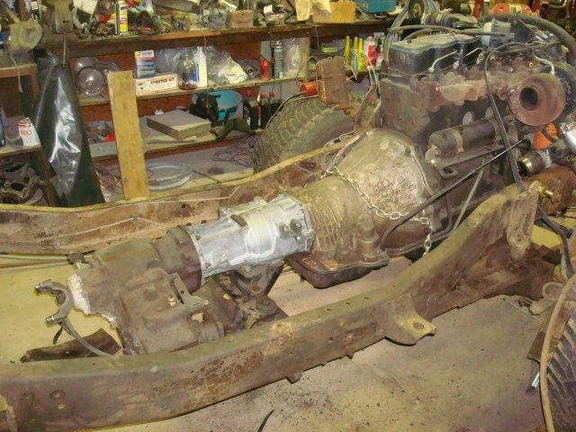

On my rc, which had a 91.5 donor with a 518 auto, like yours, I simply used the donor cross member, moved it back 1 hole in the frame, and used the plate with the tab toward the rear. I did torch out the holes in the plate a little toward the front of the truck. If I recal it was about 1/2 inch or less. This was the only pic I could find.

Used the cc at the shop today and made a mock up plate. Holes lined up well, so we cut one out of 5/16. I will bolt it in tomorrow. I bet someone could make some money if they made a kit for this conversion, a new diesel tank with straps, trans mounting plate, and a longer tail lighting a towing portion that clips into the ctd harness and you would truly have a bolt on conversion. Maybe even through in a drive line.
