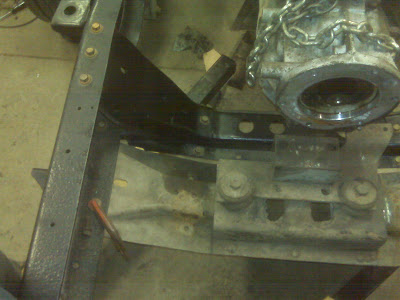

This is what I have under my nv4500. It is set back 1 set of holes in the frame. The plate under the piece of square tubing is also factory. I think is is flipped upside down from stock. Sorry for the out of focus pic.

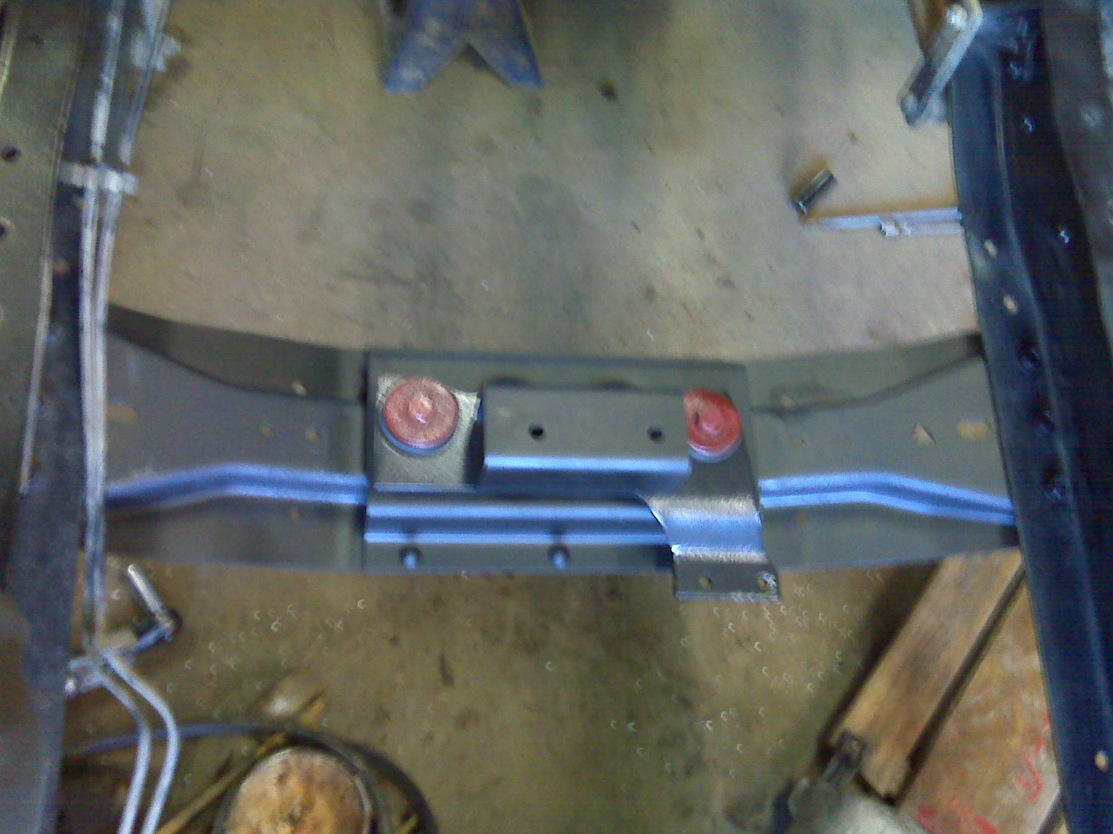

This is the stock ctd cross member. I think it is out of a 92 or 93

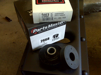

Here are part numbers for new isolators.

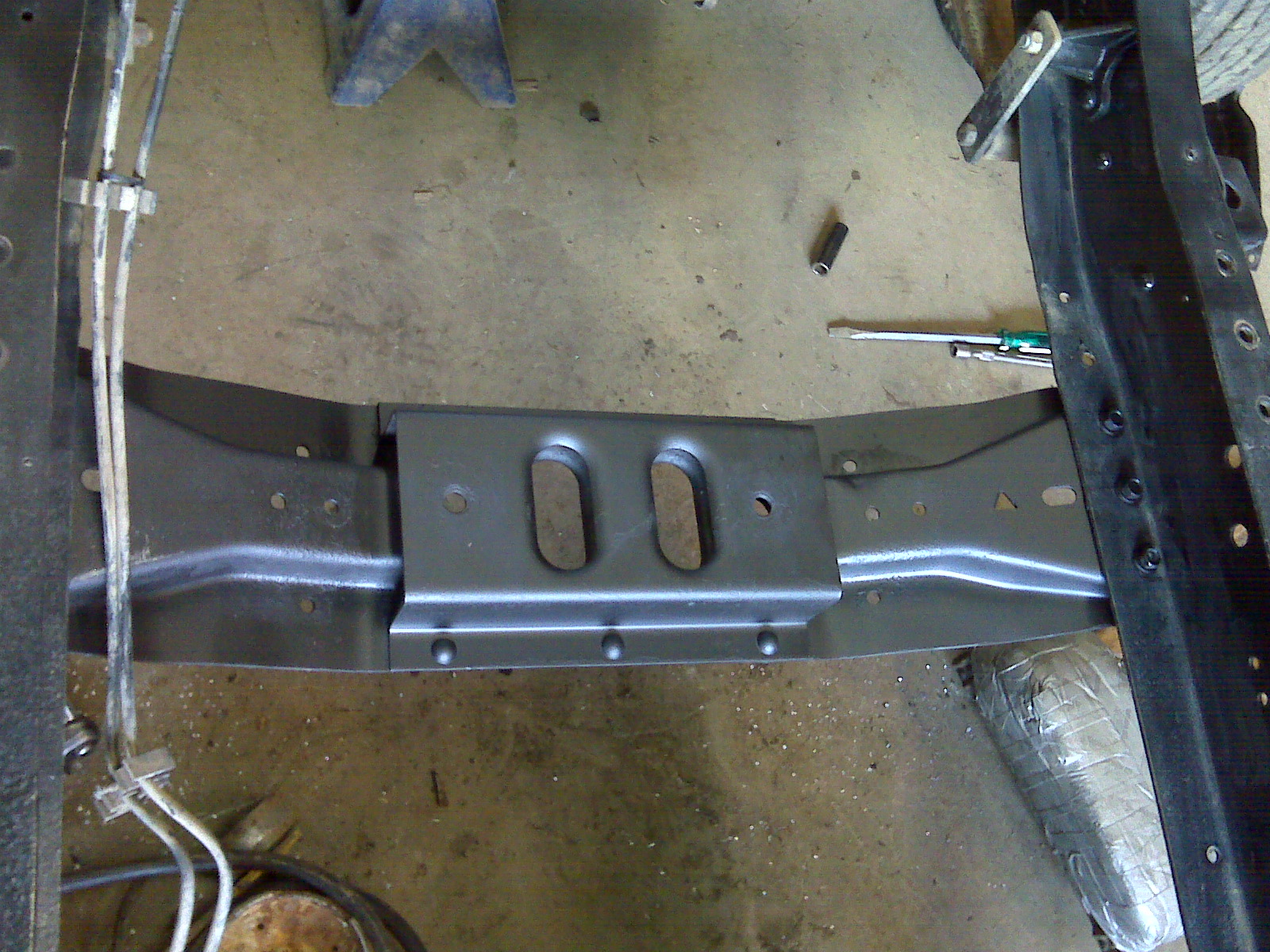

Sorry for the multi-posts, but here is the set-up the way it was when it was in the ctd truck. The bright member is what was in my crew. The dirty one is the one I put in from the donor. With an auto, the piece of square tube would be gone and the tranny would mount to the plate. You can see that the tab on the plate is now forward and up, where in the other pics, it is rearward and down.
