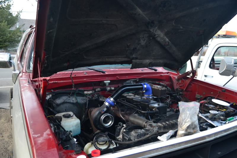

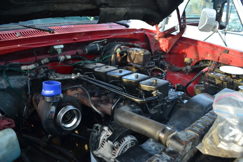

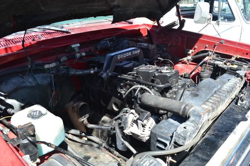

So like any good hot-rodders, we could not leave it alone for long.
I have a '94 CTD parts truck so Will and I decided we wanted to go with the bigger turbo off of it.
So off came the stock turbo and exhaust manifold
And on went the 2nd gen turbo and exhaust manifold.

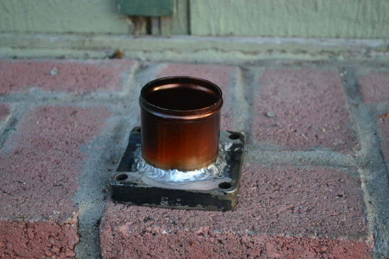

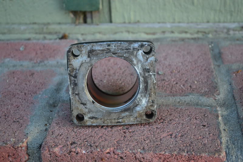

We weren't putting on an intercooler at this time (will probably be going with the 2nd gen IC) so we needed to fabricate a new path for the compressed air. The non-ic 1st gen air horn was much too small and the 2nd gen air horn wasn't really gunna work in a non-ic'd setup so...
We took off the elbow off of the compressor and managed to squeeze a silicone coupling over the flange. We then took the first gen air horn to a buddy who cut the flange off, turned the flange in a lathe, and welded on a stub of 2-1/2" aluminum intercooler tube that Will had laying around.

Then with another piece of Will's spare intercooler tubing and a spare silicone elbow, voila:
The new turbo spools up much quicker now and I don't have to sit for 30 seconds or more spooling up to spin the tyres.
The old turbo was laggy, but seemed to hit harder and pull stronger once it got going. Unfortunately we never had the chance to see what kind of boost numbers it was producing.
The new turbo spools quickly but my a$$ dyno says it isn't pulling as hard. It tops out at just under 30psi without the wastegate actuator hooked up to a boost source, so perhaps some fiddling with the wastegate is in order.
Some of the lack of felt performance issue might be psychological, as I had just spent the day in-between the old and new turbos driving around Will's modified, and surprisingly quick, turbo van which pulls much harder than the RC ever did.
Anyone know what the stock boost #'s were for a 1st gen non-IC'd engine as well as for a '94?
