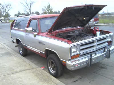

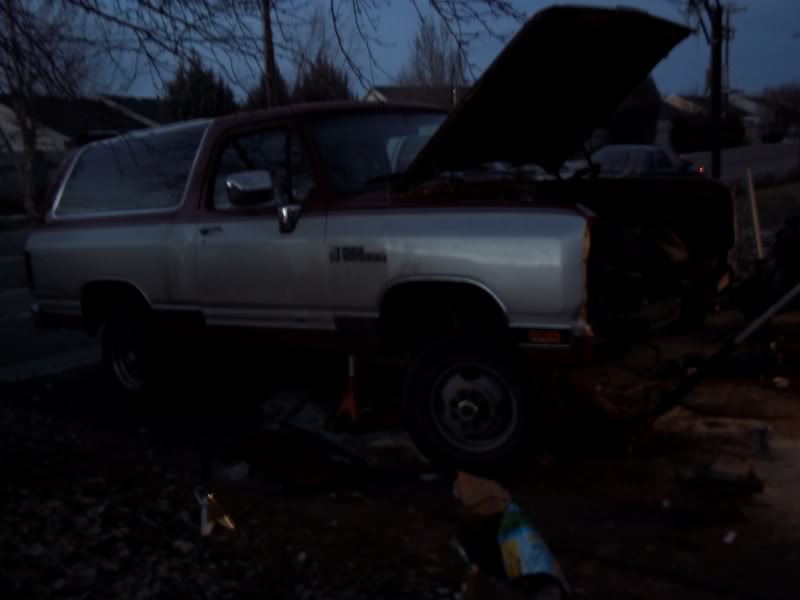

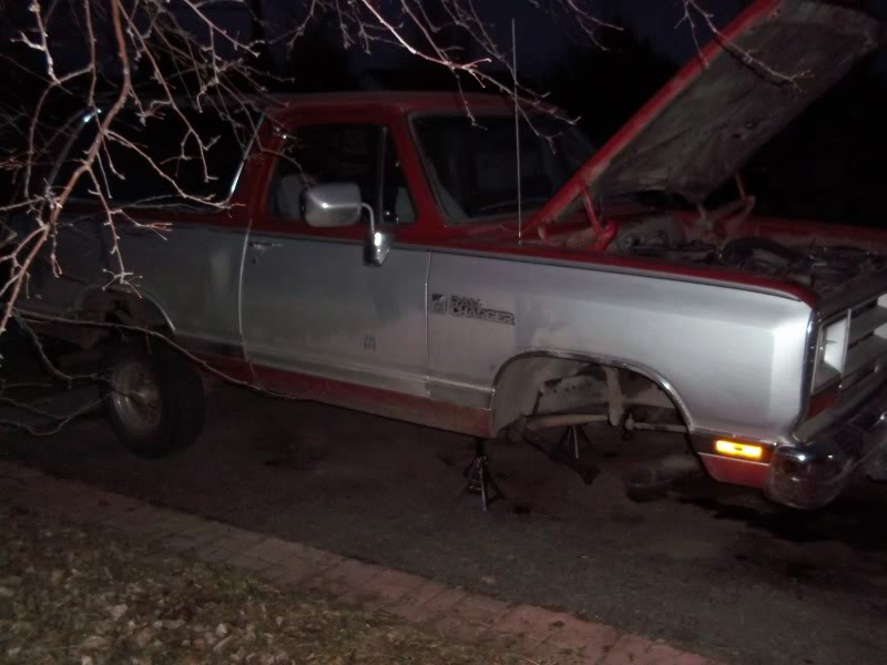

Started out with me selling my '91 Jeep cherokee
and buying a '90 Ramcharger from a tow yard in Sacramento. $800
Rust free piece from Montana with a 360/A518/4x4, factory tow package, and a few other interesting options... Had an Ign pickup issue (shut off with no warning), but we drove it the 100 miles home with no issue. 12mpg.. ug
(crummy cell phone pic)

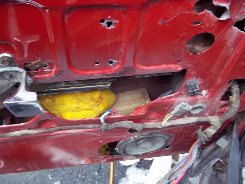

Found this holding up the window in the driver's side door when inspecting why the window wouldn't go down:

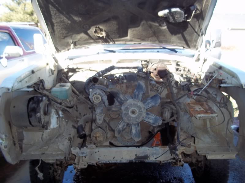

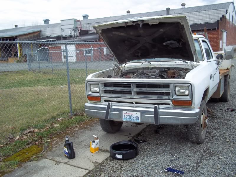

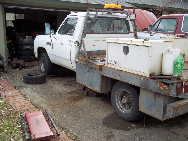

Then the search for a doner... Far and wide... Found one in Centrailia Washington.. '90 W350 5-spd rust free farm truck... 670 miles from home according to Mapquest.. So we (good friend Will, girlfriend Erika, and I) drove up on the Wednesday before last (February 2nd).
Went to purchase the truck Thursday morning, Will and I did a few hours of work on the truck to make it road worthy.
We then drove to Portland to stay the night. Headed for home late Friday morning and arrived 10-ish that evening without any issue whatsoever. I love 1-st gens
Will drove the truck the entire way back (he's 6'-4", not very easy in a single-cab) no radio, and moldy Washington stink for 670 miles. Will is THE MAN

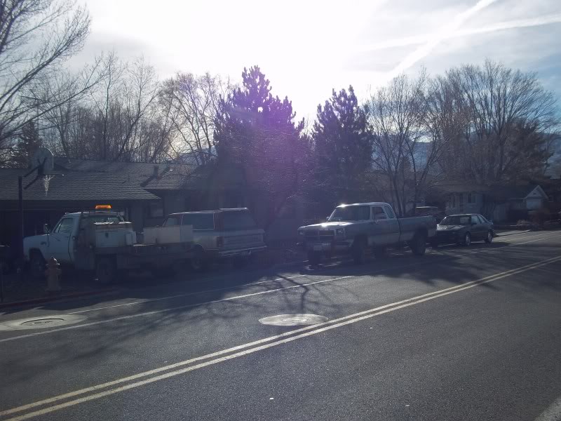

Erika and I brought down the Ramcharger to Will's house on Thursday of this week (February 10, 2011).
Will's house is late model Mopar Central ('87 Shelby CSX, '89 Shelby CSX, '90 Plymouth Turbo Van in the 14's, my doner '90 W350, my '92 W250, and my '90 Ramcharger):

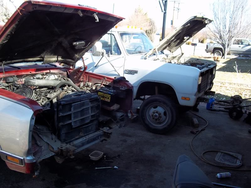

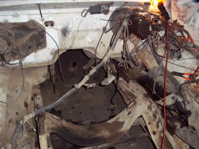

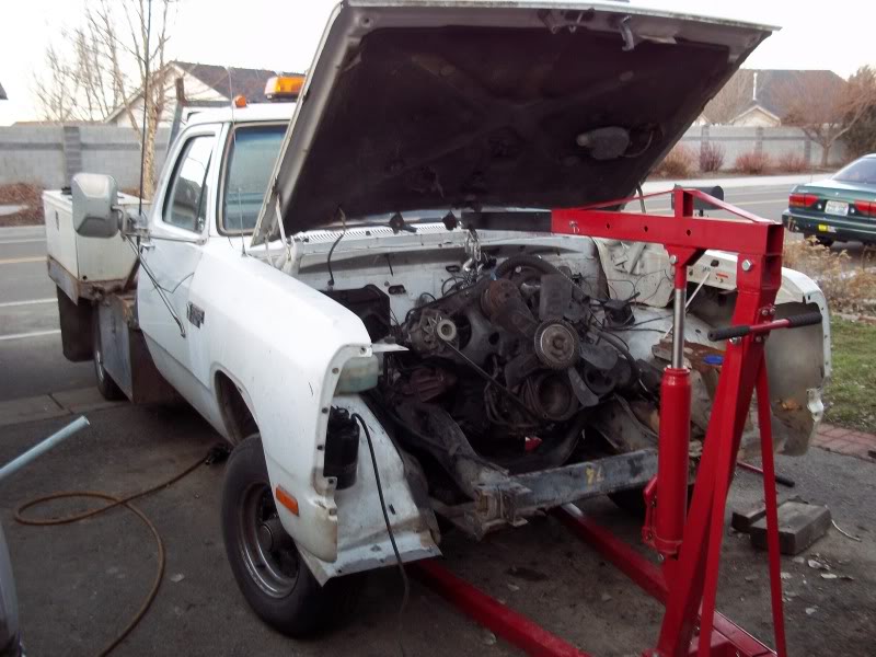

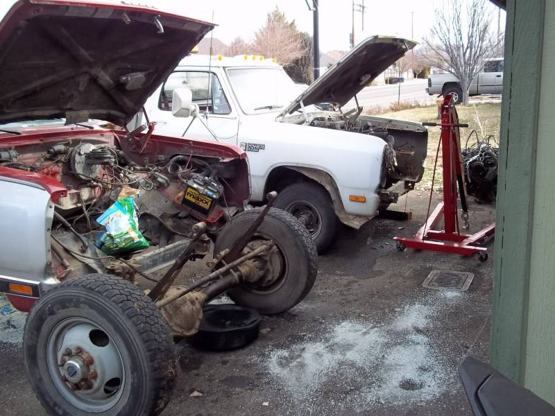

So we started the swap Friday evening (February 11, 2011). We got the front axle assy. out of the Ramcharger;

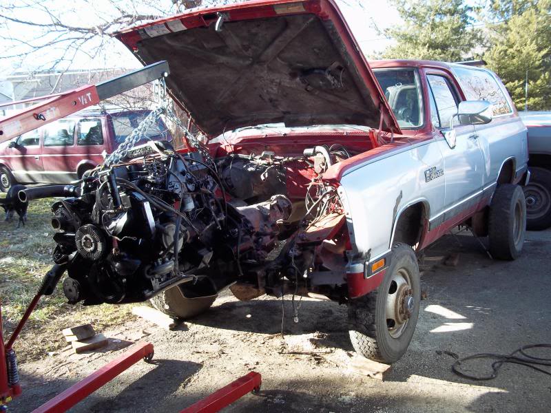

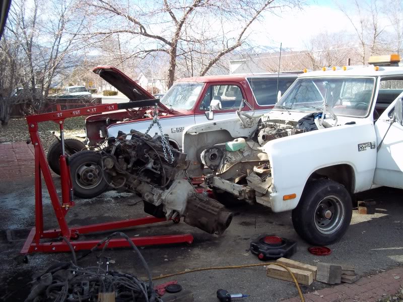

Saturday afternoon we began the removal of the engines...
VERY easy with the core support removed;

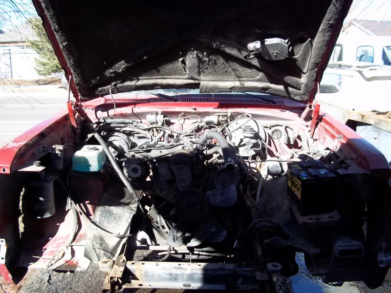

Ramcharger bay:

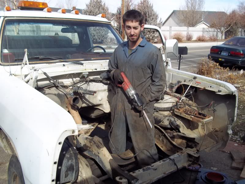

W350 bay:

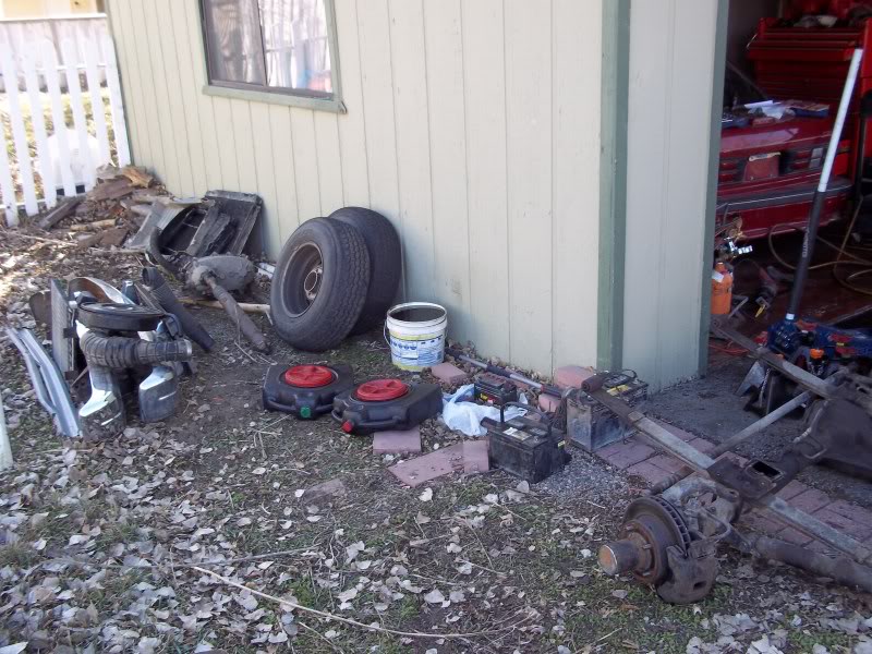

Some of Friday and Saturday's parts:

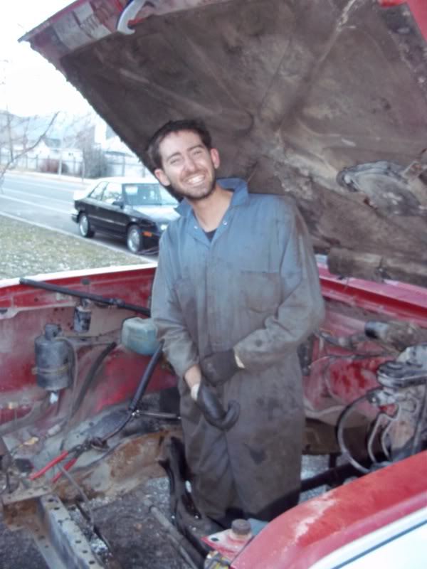

Ubiquitous "I'm in my engine bay" shot:

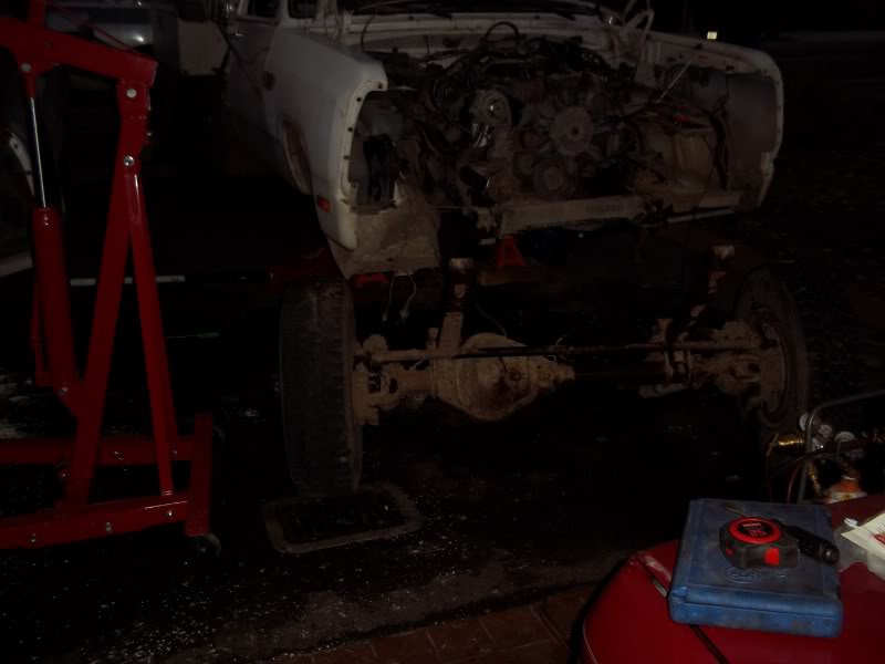

Also got the front axle out of the W350, replacing it with the Ramcharger axle. Ever see a 1-ton Dodge pickup with a 1/2 ton front axle?.. Very rare factory option package, intended as a factory lightweight for sled pulling.. kinda like a 1965 Cornet W051

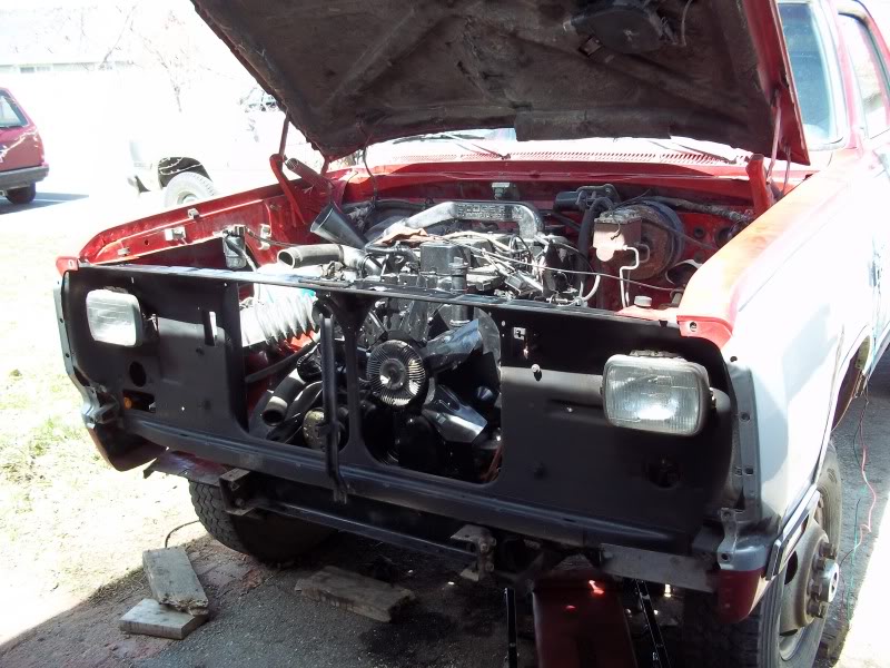

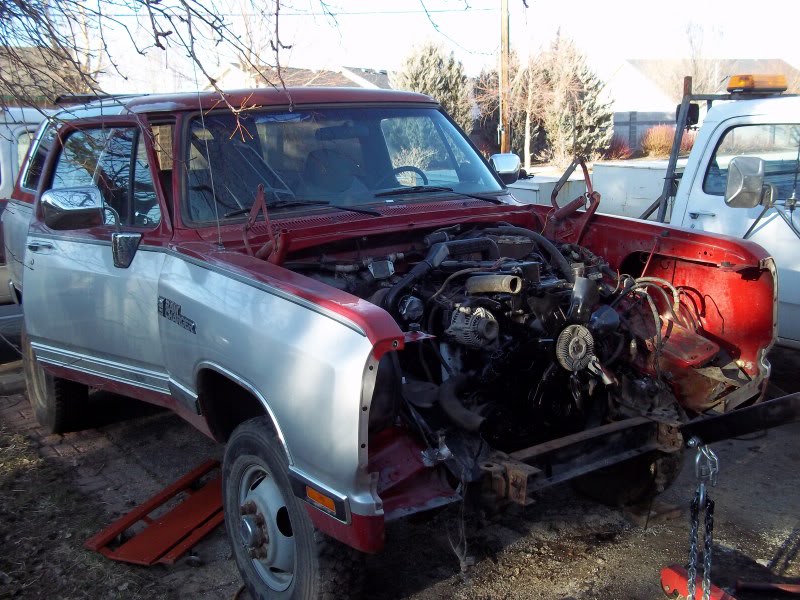

Ramcharger bay:
W350 bay:

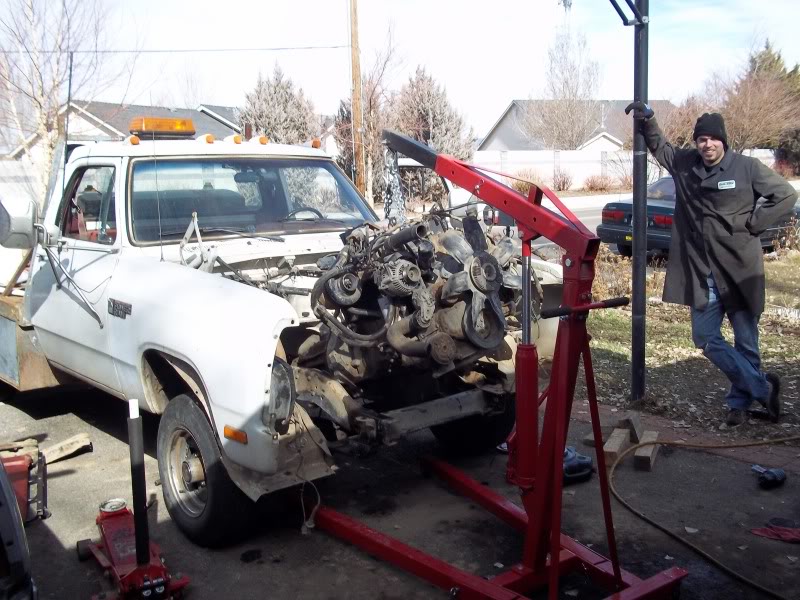

We went at it again yesterday (Sunday, February 13, 2011):
Had to pull the 350 forward a bit to make room for removing the CTD
The "Cail rake" from the 1/2 ton axle makes it even easier to pull out. Will grins in accomplishment.
Time to assist the exhaust in releasing it's grip on the truck;
Removing the brake master and booster assy to swap out with the 1-ton unit, already took out the bay wiring harnesses out of each vehicle;

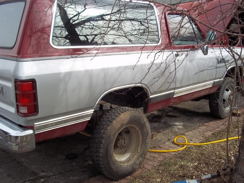

Ramcharger with the rare heavy duty front axle option;

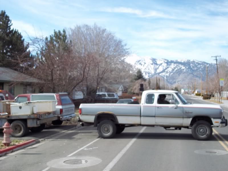

Well, it's going to be highway/offroad

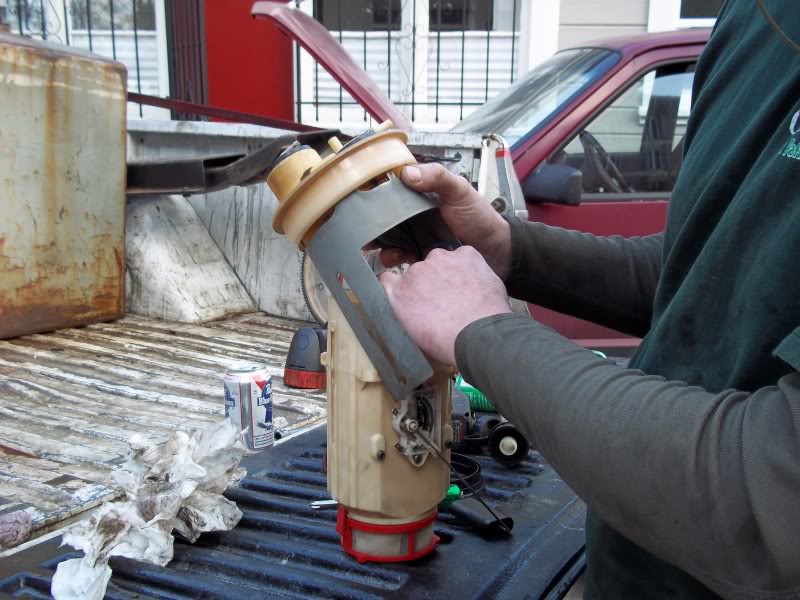

Getting out of Sacramento I started to have water in fuel issues, stopped at a shady fuel station north of Sac called JJ's Or J&J's and pumped 10 gallons of "diesel" to thin out the water issue.. It was more like 9.5 gallons of water and .5 of diesel. :evil:
Barely made it to Orland, traded tranny and t-cases, then drove back towards home. Took 4-hours to get to Sacramento (normally 1.5 max). Luckily my sister lives in Sac, so we stopped there, and I began working on the truck.
With my limited tools (didn't bring tool box.. stupid) I managed to pop the fuel sending unit up just enough to snake one of the tranny cooler hoses' down into the tank and siphon out the "fuel".. Ingested quite a bit of ATF and diesel... not fun
Buttoned it back up, put more fuel in, fired it up and damnit I didn't get all of the water out couldn't get the hose in all of the way.
So I called up Will the next morning, and he drove down with more tools and his expertise. We ended up having to empty the bed of tranny, t-case, a couple engine blocks and some other crap, unbolted one side of the bed and loosened the other, jacked the bed up, pulled the sending unit, pumped out ALL of the "fuel" put it back together, changed the filter, bled the lines, and voila problem solved.

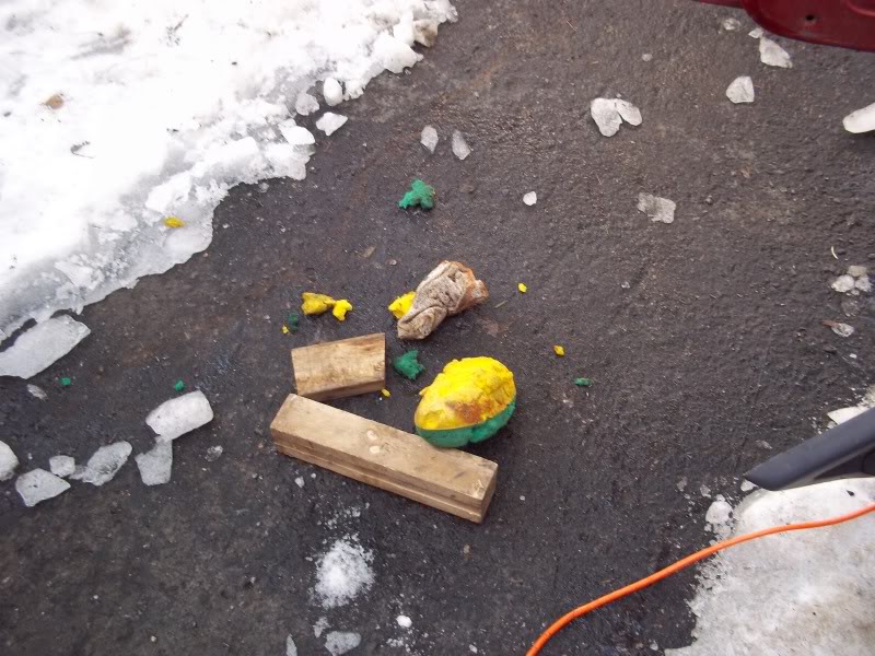

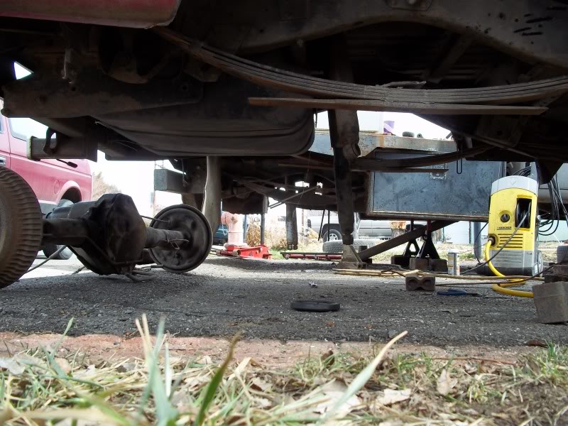

Swapped over rear axles.. Had to cut off the U-bolts on the Ramcharger.
Keeping the ramcharger springs in the RC and the 1-ton springs under the W350 (W150 now), so the RC isn't so bouncy. Had to have new U-bolts made. Taking the W350's overload springs for my W250.
Now a W150:
And a Ramcharger with a 1-ton drivetrain:
Looks funky with the dually wheels.. I will be trying to find a set of 3/4-ton hubs and go with some regular offset wheels.. Or stick with the 1-ton hubs and run surplus HMMWV wheels as PapeCAT suggested.

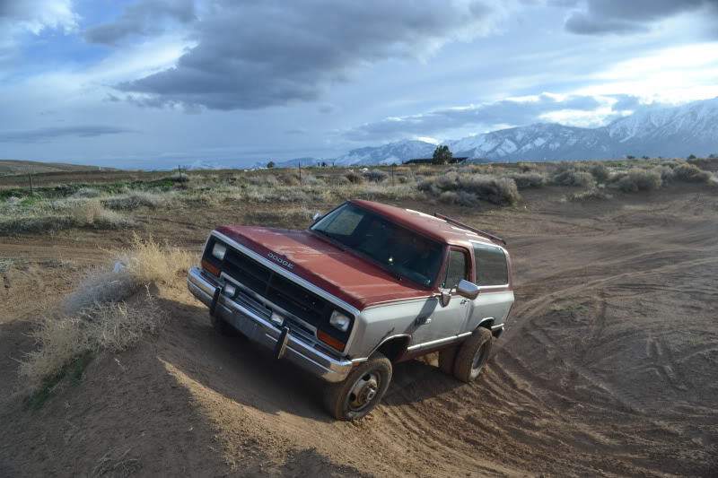

Blacked out grille:
She doesn't flex much with the 1-ton springs in front. You can tell the stock RC springs in the rear want to flex. The ride is MUCH smoother than my '92 W250, despite the short wheelbase and hard as steel tyres.
So far we've driven her about 150 miles and have had zero issues.
I registered 'er yesterday in the state of California without much issue. She told me I needed to get it smogged, and I told her that it was a pre-'98 diesel. She said her computer still said it needed smog, so her supervisor came over and had her write an affidavit stating that it was exempt due to the diesel engine. That was that.
Will whipped out more of his skills yesterday in fabbing an exhaust; just a simple 3" all the way out the back, sans muffler. Can actually listen to music or carry on a conversation now. Seems quieter than my '92 W250 with the downpipe to 4" muffler to 6" all the way out the back.
I took her to some scales yesterday as well.. With the heavy dually wheels and tyres, and 3/4 tank of fuel (Ramcharger tank holds 34 gallons :shock: ) she weighed in at 6,020 lbs. She should weigh a few hundred less when I swap the hubs and wheels from my w250 onto her (and vise versa).
