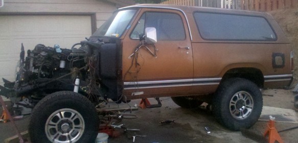

Update May 13
Fabbed up the NP 203 shifter with a plate of 1/8th inch plate and some pipe. I am often amazed at how much better simple is!!
Bolted the 727 behind the Cummins without any issues. This is truly a "bolt in"! Crossmember bolted right up.
The fuel filler door was welded in and the diesel filler tube installed. Just waiting on fittings for the stock sending unit and then that will get put into place.
The axles are in place and the 35s look better than expected on this with just a 4 inch lift!!
I think there is a light at the end of the tunnel!!!Hope it isn't a freighttrain!!
